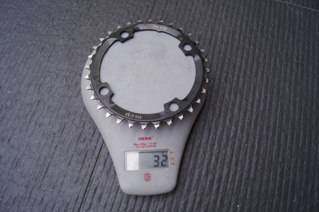

    Managed to convert 2x10 to 1x10 in less than an hour.
    BEFORE
    Three components removed: (1) Granny ring (2) Front Derailleur (3) Shifter.
    AFTER

    One more thing, it is no advisable to use middle ring as single ring. To convert from dual chainring to single chainring, some riders may be tempted to use the middle chainring as single chainring. I would not advise you to do that for three main reasons: (1) The middle ring has added thickness around its teeth to allow chain to switchover to another gear. The additional thickness may narrow the clearance and cause the ring to rub against the plate of the chainguide; (2) Due to the additional thickness of the middle ring, the weigh is normally heavier than the dedicated single ring; and (3) The single chain ring was proven stiffer than the middle chain ring.
    I was using XT 32T middle ring as single chainring. The black color material around the ring was rubbing against the plate of the chainguide. Not an ideal solution. The weight of the middle ring is 55grams.
    The design of MRP 32T single chain ring is simple and clean. The thickness is smaller than the XT 32T middle ring. It only weigh 32grams.
    The photo shows the 1x10 setup that used XT 32T middle ring as single ring. Due to added thickness, the ring is rubbing against the plate of the chainguide. Adding BB spacer might not help as the chainline will be compromised and the rubbing will be passed on to the derailleur cage
    The photo shows the 1 x 10 setup that used MRP 32T single chainring. The design is clean and sleek. Absolutely no rubbing. The chainline is perfectly aligned with the cog, and the ride is so much stiffer.

    Interesting.
    I clicked around a bit. The teeth on the XT ring are steel. The MRP ring is aluminum. The black stuff is a carbon composite. So I suspect that the weight of the teeth of the XT ring is the difference you found.

    Quote Originally Posted by AndrwSwitch View Post
    Interesting.
    Thanks for the info. I think you are right about the additional weight cause by the carbon composite.

    Quote Originally Posted by David C View Post
    Sure is always better to use the right tool for the job, like a SS ring in your case.
    On mine I just kept the middle ring (steel 32t) since I already had it and was working fine. But I'll definitively go for a SS ring anytime I have to deal with a single ring setup.
    Just to know, how thick your MRP ring actually is ?
    The thickness of the MRP single ring is 3mm.
    The thickness of the XT middle ring is about 7.5mm.
