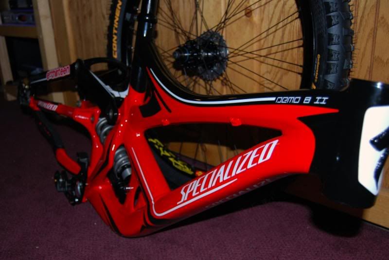

    Just two teasers for now. It will be done Friday hopefully. Every step of this build has been a total hassle. Been off the bike for about 2 months with an injury, get the Docs ok Friday.
    - Fork re-build turned in to needing a new part for the damper and a cracked ti spring in my 40, tack on and extra 350 and settling for a steel spring. Parts 2day aired from Fox to NC, should get there this am, fork gets tuned and put back together today and sent out. If ups doesn't eff up it should be here friday night so I can ride Sat.
    - My sweet manitou ti spring I had was too long by about 3mm, tack on another 180
    - BTI and QBP out of the raceface 83mm bb conversion kit, ordered online but ended up being back ordered. Got it yesterday after a 2 week wait.
    - Headset cups Specialized put in were wierd and they couldn't tell me what bearings worked. 36x45 didn't work correctly and 45x45 didn't even fit in the cups. Pressed them out and luckily had e-13 cups laying around.
    - Rear spacing made the chainguide really far from the iscg tabs, bolts were too short so needed and iscg adaptor flipped, got one from a friend, it was iscg 05, I needed old. Tack on and extra 45 to overnight one to get it here by Friday.
    - Ordered Funn RSX MKII since it had ti hardware and was machined to be much lighter thant the regular RSX, they sent me the old one anyway and don't feel like waiting for a exchange and missing a ride, 60 grams isn't that important.

    i hafta say the red is way brighter in person.. def. diggin' it.

    Man love those colors

    looks so freakin sick already!!! good job.

    It all came together finally.
    Fork: SEx tuned 40 w/ Risse top crown
    Shock: RC4 w/ Ti spring
    Cranks: Raceface Atlas FR
    Wheels: Hopes, 823s, DT Champions
    Bars: Spank Spike Polished
    Post: Thomson
    Brakes: While Elixir CRs
    Stem: Funn RSX
    Shifter: Saint
    Rear Der: Saint
    Chain: KMC SL Gold
    Guide SRS+
    Chainring: E13
    Tires: Continental Der Kaiser 2.5
    Came in a nut hair under 40 at the shop with the steel spring in the 40. Still waiting for a Ti spring for the fork since I cracked mine. Big thanks to Suspension Experts in NC for 2 daying the parts for my fork from Fox no charge and getting this thing back to me for the weekend.
    Compared to my Gran Mal this thing is longer and lower and I kept clipping a pedal while pedaling through turns in the parking lot. There is definitely going to be some getting used to with this thing. Yuroshek is on his way over so beers tonight we are checking out Blue Mtn in PA tomorrow. Pics, hopefully video and a ride report will be in order tomorrow.

    Holy sh*t that thing looks so sick!

    good looking build

    I bet you'll like the Kaisers. Good tire.

    I thought there'd be more colour-matching going on than that, but still... Good job on the build.

    long really? when i rode one, it felt pretty short. im on an R9 though so maybe thats why.
    looks sick though

    Awesome bike man How long are your cranks?

    Running 165s and clipped a pedal quite a few times today but that is just going to take some getting used to. Compared to my Gran Mal this thing kills turns. Really impressed so far but need more time on it. It was super greasy at Blue today but the Kaisers had a real predictable drift. My hand was killing me most of the day and I ripped a 2" gash in my tire so ended the day a little early. Looking forward to Diablo tomorrow on some trails I have wired.

    Is that a 2010?

    yeah that's a 2010
    2010 Specialized Demo 8 II (Upgraded to II from I)

    Looks very nice mate.

    I think it looks legit - people are color matching too much these days.. This looks good.
