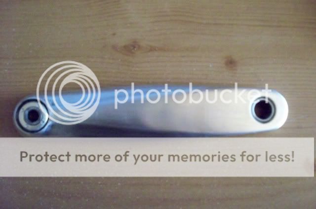

    340
    No good Oven Cleaner
    I need some more advice
    IMG]https://i511.photobucket.com/albums/s360/solarimtb/100_0535.jpg[/IMG]
    if you can see the little white dots it looks like thats the metal so i stopped

    rd3
    rd3 is offline
    Reputation: rd3's Avatar
    Mar 2006
    91
    try some sand paper now, 120 then 320. then some steelwool with water or polish
    Feb 2006
    1,737
    yeah start sanding.
    How long was the oven cleaner on? Why does it look more black by the BB side?
    340
    Good job! Victory
    I found some 400 grit sandpaper and did work
    Now i need some polish to give it a little shine, not a mirror but a shine

    340
    thx for the info, if I leave it raw as in the picture above, will i need to keep doing something to it to keep it looking good? so if i dont start to polish it then i wont have to polish it in the future?

    340
    started the other one today. I think that i might just keep them the raw like the above pic. If I do, will the rub from my shoes make it shine and then the other parts will still be the raw?
