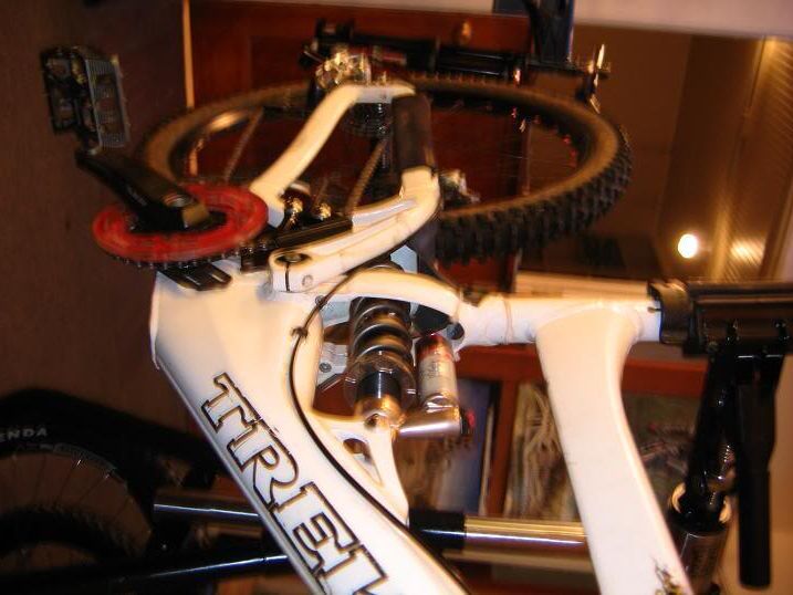

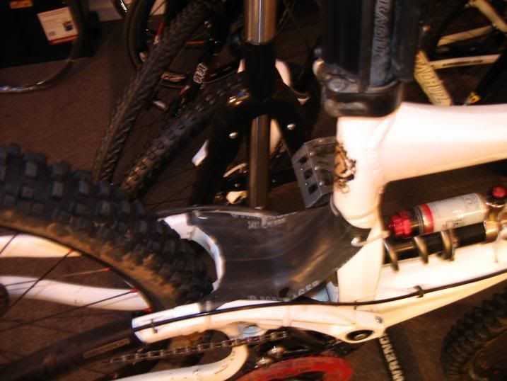

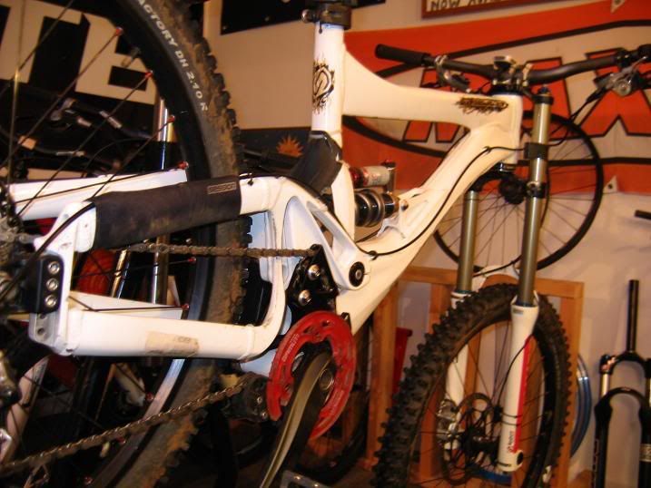

    There are some obvious problems with the frame and were clearly missed by those at Trek. The main issue than got me was that riding in anything other than completely dry conditions would fill the linkage and force the bike further and further into the travel. I fixed the problem by creating an inner tube fender than keeps the mud from being thrown directly into the linkage. I talked to Trek about this numerous time and each time the tech would say to put a shock boot over the shock to prevent it. Obviously he either wasn’t paying attention to what I was showing and explaining or just didn’t care.

    The fender I had to made to keep mud and debri out of the linkage:

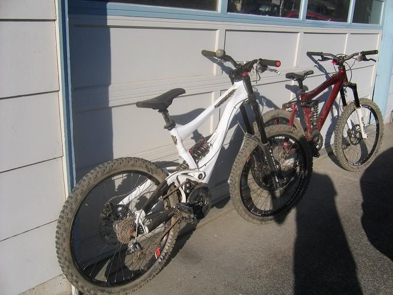

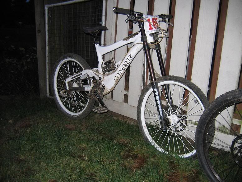

    The many different phases of my Session 10(s)

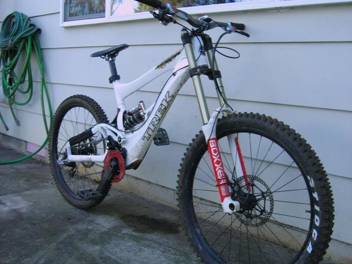

    Current setup:
