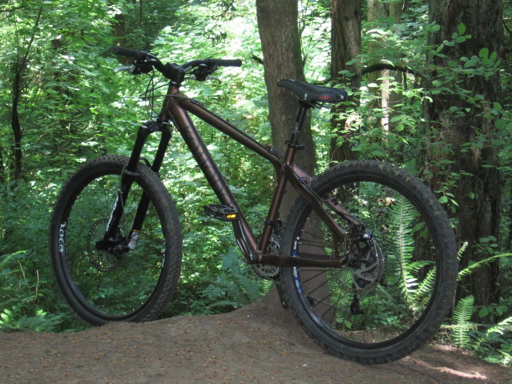

    Well, I decided to give the bike quite a bit of trail time before giving it a review. I've had it for about three weeks now.
    Built up from frame only.
    Specs...
    Frame: 2006 Jamis Komodo 3.0
    Fork: 2005 Marzocchi Dropoff Comp. 20mm Through axle. 130mm of plush SSV damping.
    Cranks: Truvativ Hussefelt Silver, 22/36 w/ E-thirteen bash
    Pedals: "Alpine"
    Drivetrain: Deore FD/RD Alivio shifters. 16sp
    Brakes: Hayes IH2
    Casette: Forte' 8sp
    Seatpost: Truvativ XR doubleclamp
    Saddle: WTB Speed V comp
    Stem: Truvativ Hussefelt
    Bars: Specialized OEM
    Wheels: Rear: WTB Dual Duty laced to an alivio hub. Front: Performance forte' Loco
    Tires: Rear Kenda kinetics 2.3 Front Specialized adrenaline
    Total Cost = $550.00 (with the cost of some tools)
    The Ride, This bike is seriously amazing, I was surprised with the quality of the frame, and the color is even more stunning in person. all the guys at the local shop love it.
    The pros: Great Geometry in a cool size, 16.5 just big enough for trail riding and FR but small enough to jump and be flickable in the air. That brings me to my next point. The bike is so agile in the air, I can pull off bigger whips with this thing than most any other bike. The frame is really confidence inspiring, I've never been on a hardtail that is this fast. I'm going to try DH racing this thing, because its scary fast. the fork is a little more raked out, but thats what makes it so stable at high speed. With the seatpost up a little, I can climb forever. This might be because I'm also not used to a proper saddle and 22 tooth chainring. but the komodo sure makes it uphill faster than my DH bike.
    The cons: very terrible tire clearance. The rear wheel is terribly difficult to remove. due to the frame design. I'm able to say, max rear tire size is 2.3 with a perfectly true wheel that is perfectly centered as well. playing it safe would be to find a burly 2.1"-2.2" tire that can handle DH.
    Overall: Fantastic bike! definatly a FR worthy hardtail. I'll be taking it down to blackrock falls city some time soon, the bike will go to whistler in july. I'm using mine as a XC/AM/FR bike. so far its been perfect for this application. Jamis said that the frame is 8" rotor O.K. and the bike can take up to 150mm of travel. so if FR is your game, this is your rig. Great product and GO JAMIS!

    Could you take a closeup pic of the triangular TT/HT gusset?
    All the Komodos I've seen in person have had a misshapen/misaligned gusset there with hella sloppy welds. Everyone loves the ride though.

    Hey tod nice build job... how hard was it to work with th Komodo frame I'm just buyin one now to build up with a fox vanilla and a x.7 kit... 2.2 tires? really... that sucks get some stiff rims and go 2.3

    Would the Komodo be good for urban riding because people told me it's dirt jump/trail riding oriented.

    the Komodo would be an excellent urban riding bike the only problem is its a little bit over kill for curb jumping.

    Cool bike. Reminds me of my Vagrant. Same stem, saddle and Loco wheels. Do you know the weight?
    Komodos have quite a variable weight. I've seen some around 30, but mines a bit heftier. The build makes all the difference.
    Mine is just over 35lbs:
    Ok, yea. My Vagrant weighs 35 as well.
