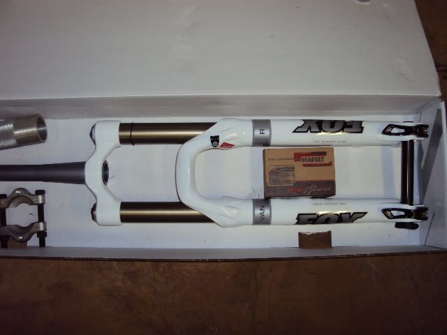

    Desperately looking for a Fox 36 steerer in 1.25 or tapered. PM me.

    Sorry, tapered steerer. I currently have a 1.5, and I need a tapered or a 1.25 for a new frame.

    Yes, uppers, OK, so I need a 1.25 or a tapered steerer, crown and uppers for a fox36 van.

    What is the size of the headtube of the new frame? 1.125" top and bottom?
    You have a fork that is 1.5" top and bottom? If that's the case you need to buy a new fork. You can go from 1.125" fork to a 1.5" headtube with adapters but not from a 1.5" steerer to a 1.125" steerer.
    I think there's some confusion with the term tapered. A "tapered" steerer measures 1.125" (1 1/8") on the top and 1.5" on the bottom.

    Yes... and his new bike has a tapered headtube... so he can use either 1.125 or tapered steerer.
