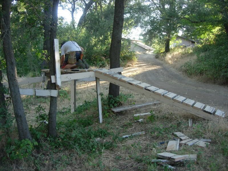

    Well I started riding a few months ago, and I really like the ladder drops and stuff, even though I havent done any. lol.
    My brother is pretty good at them (Robert aka RC_Compton on here) and he is usually the crazy one, so I decided I wanted to build some stuff with my friends to build up our skills. We looked at the property we had to work with (private, renting but the owner is super cool and I okayed everything with him) and decided on a few things we wanted to do. This included some drops, 3ft to 10ft, some jumps, and some downed trees to ride on.
    We started it today after work, and in about 3 hours we got this ladder built. It is 5ft from the drop to the ground, but the landing will take some of that height out. We used some old wood that we replaced on our deck, and the landing will be filled with dirt (the plywood is to hold the sides up). I need to get the landlord to bring his tractor over since the dirt is pretty hard.
    Here are the pictures. I know it's not huge, but the biggest drop I have done so far is like 2ft, lol. Let me know what you think! (good or bad)

    pretty sweet but u'll def wanna go WAY bigger after u hit that lil bugga. but nice start for u to learn on. looks like a blast just gettin all creative and buildin those things tho.
    True dat. You could probably even use a bigger gap in between the drop and the tranny too...maybe a couple-three feet or so more.

    Yeah, we were thinking of pushing it out a little further, but we didn't know. We haven't done any like this, so hopefully it will work out. I figured it might be better to have it closer at first so we don't case it (or not even make it to the landing ).

    be carefull with pallets
    More durable pallets are often made from different types of hardwood that splits when you nail it when its dry.They usually put them together wet and then let it dry or pre-drill and screw them together. Try drilling before you nail or preferably screw things together if it's a hardwood pallet. The soft pine pallets are typically what you find thrown away and they can usually get nailed together ok but the wood is so soft and weak that it doesn't last long under the kind of loading free riding will subject it to. That being said you could triple stack the boards and probably be ok. Good luck and have fun
    Trust me. If you're going any faster than 'pedal kick drop' speed, you will easily clear the gap that's on it right now. You could start at a stand still on the ground right at the base of your up ramp and still manage to get enough speed to clear the current gap w/o pedal kicking.
    Let's say you had a long enough approach to get in 4-5 good pedal cranks before you rode up the drop, you'd probably have enough speed to clear the entire landing ramp.
    Believe me, once you get comfortable with the current setup (which won't be long), you guys will want to move that ramp out some more.
    Unless it's for a temporary setup, I tend to steer clear of whole pallets. I keep thinking of a quote I saw on one of the IMBA pages, "Pallets were designed and built for static loads, not the dynamic loads that mtn. bikes would place on them.
    I've used pallets before for low, wide ladders, but they were gusseted, braced and strengthened with additional lumber.
    Use pallets at your own discretion.

    Thanks for all of the advice guys. I was a little worried about the pallets, but I think I'll try them out and a smaller drop just to see how strong it is before building anything too big with them.
    I know I can get a 2"x4"x8' for around $2 which doesnt seem like much, but it would add up QUICK. lol. I'm a poor college student so I don't have huge funds.

    If you find yourself getting "bored" with the drops you can always make the approach ladder really narrow. Even a 5 ft drop is hard when you only have a 6" wide board to ride on. It'll also use less wood which is less $$

    You should never nail into trees...

    From what I can see, the wood landing looks a little feable. Is it complete?

    It's really strong... I jumped on it (and I weigh 240 pounds) and it didn't move... I was thinking of adding an upright support in the middle of the triangle on the sides though.
