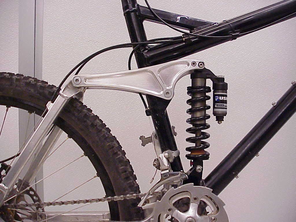

    Good stuff EBX! In all actuallity, I think only a few homers did option "A". I bought a DHX for my RFX with the full intention of sending it to Darren for the factory race, but there was a 5 month wait till it was availabe, so I did get some dirt on it prior to sending off the shock.
    Option "B" is probably more common amounst the homer nation.
    Uuuuummmmmmm, factory race system.....yummy...:
    Why......I oughtta.......
    Rene, you just HAD to rub it in with the pic of the DHX sitting nicely on the old-skool RFX, didn't ya? I'm holding out hope that Darren gets his parts figured out and re-releases that to the public down the road.
