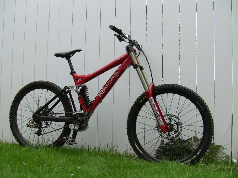

    Slowly making some updates to a Sunday that I picked up in rather good condition last fall. I am doing a new 2011 Boxxer r2c2 fork swap currently and was also doing some research on HA's, and so forth.
    I know the Sunday has a 65 degree HA, alot of your modern day DH rigs, DHR, Evil's, Kona's etc all hover around the 63-64 area.
    I was wondering if it would be beneficial to go ahead and swap to the zero stack angleset and get the HA around the 63.5 around, seems to be a pretty common area. This bike has never really felt alot more slack than me EVO which is 66ish with the modded seatstay I have.
    The rest of the bike I cant really change, and im completely happy with its performance and its not breaking the bank to get a new rig. This would bring it to modern day HA standards somewhat.
    Yes/no? Input?

    Works great heres mine
    13.5 bb, 0 degree bottom and -1.5 top 63.5 ha, 47.5 wb its a large
    Got this large frame from a buddy so i stripped it polished it and built it up with my parts.
    36.8 lbs now with dura ace and dh tires.
    Did the angleset on it at -1.5 and wow what a sled. Lol
    large frame striped/polished
    2010 boxxer wc avalanche cartridge
    marzocchi roco wc with ti spring (off too avy for race tune and parts)
    answer bars
    Crampon dm stem
    thomson post
    selle italia carbon slr team saddle
    e-13 guide
    Middleburn cranks
    crampon pedals
    cc angleset -1.5
    Avid elixir cr
    hadley wheels laced to 721s
    x0 der
    x9 shifter
    dura ace cassette
    Kmc xsl ti chain

    I sold off my 2010 Demo 8 II because I hated it. I was looking for ways to update my '07 Elite. I went for some fresh paint, bearings a bit of polishing and an Angleset.
    I tried a -1.5* headset on the bottom and a 0* up top. I liked it but figured I'd try a -1.0* on top and -1.5* on the bottom which put me somewhere around 62.5*~ish.. My wheelbase ended up at 46.325"(1.125" longer than stock for my medium)
    With the new geometry I'm loving it.

    Awesome looking sunday, thanks for the info.
    On a sidenote, where do you run your bottom out chamber at for psi, and adjustment?
    Addicted
    749
    I'm 160lbs on a 300lb spring. 6 clicks LSC from from open.
    Bottom out is cranked all the way in, something like 130psi.

    Thanks for the info, I used TFTuned's spring calculator, the guy I bought the bike from had a 300lb on it, 160 also. I ended up with a 400lb spring on mine, im about 195-200 geared up. Been running about 150 in the chamber, with it screwed all way in also. 3-4 clicks from full open on LSC. Just wanted to see if I was ballpark like everyone else.
    ZERO COMPLAINTS so far on the bike.
    New Fork 2011 Boxxer R2C2 this week, and Sun Ringle ADD wheelset, then some shred time this weekend. The idea was to build this bike up, and get good parts and maybe do a frame swap in the next couple of years, but the more I ride this thing the more ammo it gives me to ride it until it falls apart.
    Where is everyone going for bushings and frame parts? Mine is an 06 Elite.....
