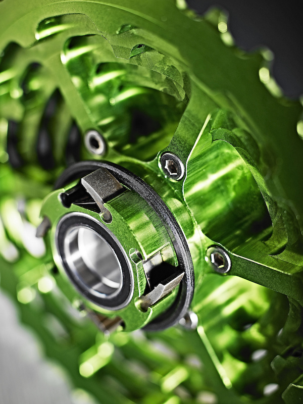

    Looking again at the more recent photo of the Hope version from Eurobike, I realize I was wrong about the cassette and hub body being one integral piece. In earlier photos it looked as if it was all milled out of one chunk of aluminum (or aluminium if you're so inclined).
    Attached Thumbnails Attached Thumbnails 9T micro drive hub by Canfield Brothers-s780_hope6speed2.jpg
    There IS a version milled out of one chunk, apparently. The full 9-36 cassette:
    The 6-speed DH proto you are referring to has riveted sprockets instead...
    Probably lots more development until either of these hit the shelves, we're bound to see more versions.
    What will be especially interesting will be to see if they come up with some kind of way to actually standardize for 9-speed cogs. A new standard freehub/attachment mechanism, in other words.
    Either way I can't wait. I want my 9-36/30T NOW!
