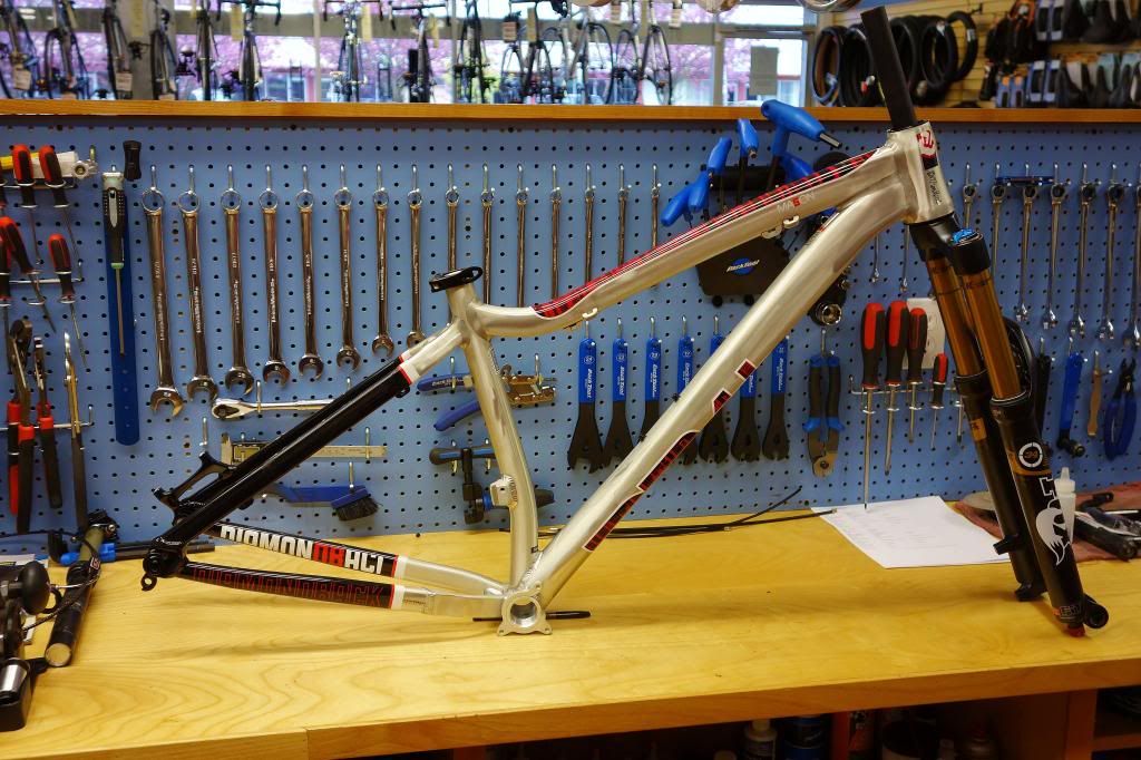

    I've been on a bit of a kick lately to put together another hardtail. I started hunting around and was thinking I'd go for a VooDoo Bokor 1 to mount up some Spank 650b wheels I have here and then my DB sales rep came in. I asked a few questions being that the frameset isn't listed on the dealer site; a few days later my frame showed up.
    Unfortunately, it will probably be late May/Early June before I get the bike together. I have almost all the parts, I just don't have time. The frame is hanging out here at the shop and with working 10-12 hour days I get to stare at it all day long. My spare time is filled with volunteer work/trail building/racing so it'll be a while.
    Build list is basically a XT hubs on Spank Subrosa rims, XT brakes, XTR crank with custom 28t or 30t spline-drive sprocket, XTR 9speed cassette, Sram XO shifter and derailleur, FOX Float RL 130mm fork, Ardent 2.24 rear/2.4 front, Spank Oozy stem, Spank Subrosa handlebars. It came with a KS DropZone seatpost but at 5'11" with a 35.5" inseem the post is too short. I have a spare Reverb and Kronolog hanging out that will probably make it on. If I end up riding the bike a whole lot I'll swap the KS LEV post from my Pivot. I'm trying to keep this as a budget built thrasher bike so I gathered some parts that are a bit out dated or won't work on my other bikes.
    Ignore the messy workbench. I was trying to grab a picture between repairs. Ignore the fork as well, it came in the same day for my Pivot 5.7c and so I used it to prop up the front end.

    Are you planning to build this as a 27.5?
    Addicted
    749
    Nope. The bottom bracket would be terribly low. I've got a 29er Fox Float sitting here along with some 29" Spank Subrosa rims.

    Ummmm messy work bench??? Where? Cleanest bench I have ever seen......lol
