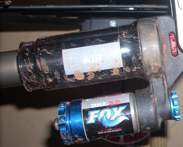

    The "Chumbified" DHX works well for me.. it is a custom shock so a side-by-side comparison with a stock DHX would be apples to oranges.

    I think the "custom" DHX means Chumba uses the small air can (RP23 can) on the DHX. It gives the shock a firmer ride through the middle part of the travel compared with the "stock" DHX.

    Fox will still service the Chumbified shock should it have a malfunction. It is not likely as long as you keep your air valve clean and make sure not to blow dirt into it using a beat up old shock pump. I noticed that air shocks run with no air caps are normally the ones that have the problems. It only takes a small amount of dirt to get inside of the shock to start wearing it down from the inside out. We do mean things to those shocks while testing them and nothing ever goes out.

    can someone point me in the direction of this "Chumbafied" DHX pls? i cant seem to find it anywhere...

    As far as I know, the only mod is the use of the smaller RP23 body on the DHX Air. There may be other differences. Any pic of a bike on Chumba's site, for example, will show the Chumbafied shocks. The are stock on both the XCL and EVO.
    You can compare/contrast that with pics of the DHX Air and RP23 on Fox's site, you should be able to eyeball the differences.

    Here's a close up of the DHX-A from my XCL.
    Here's a stock DHX-A.
