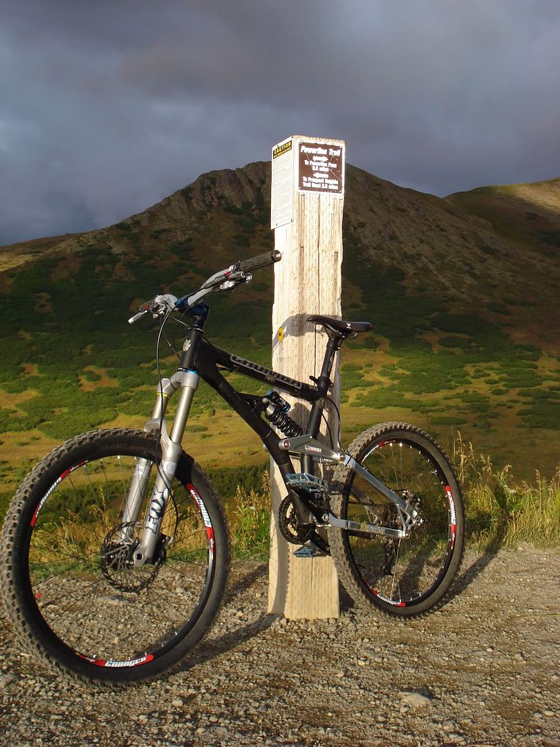

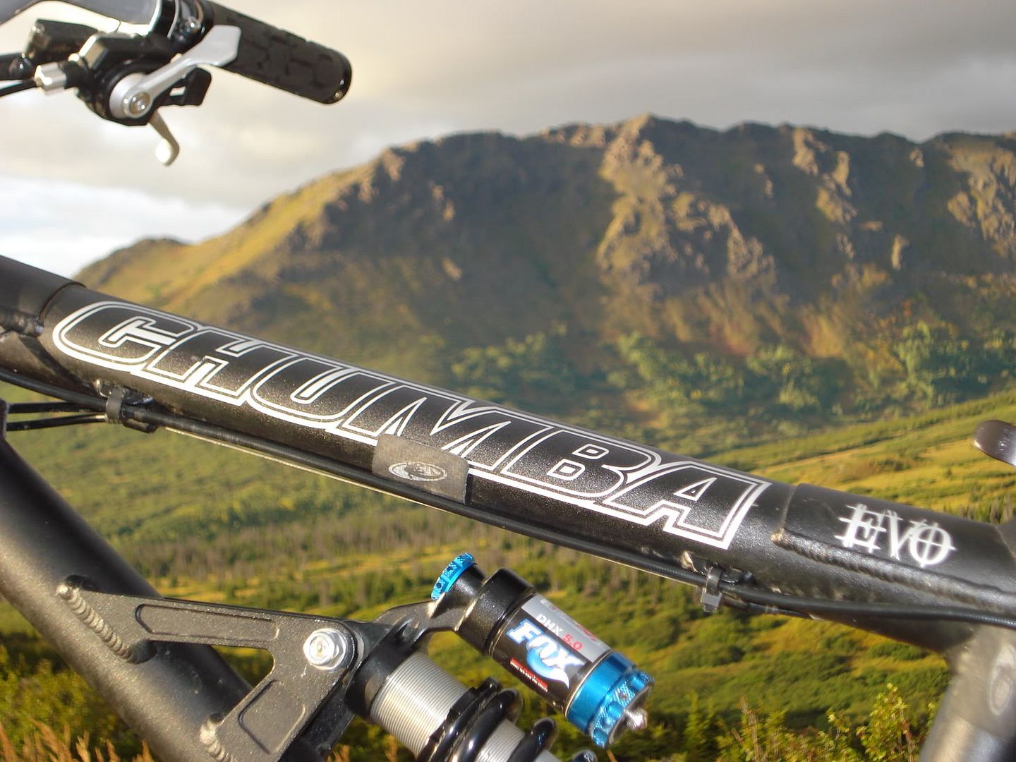

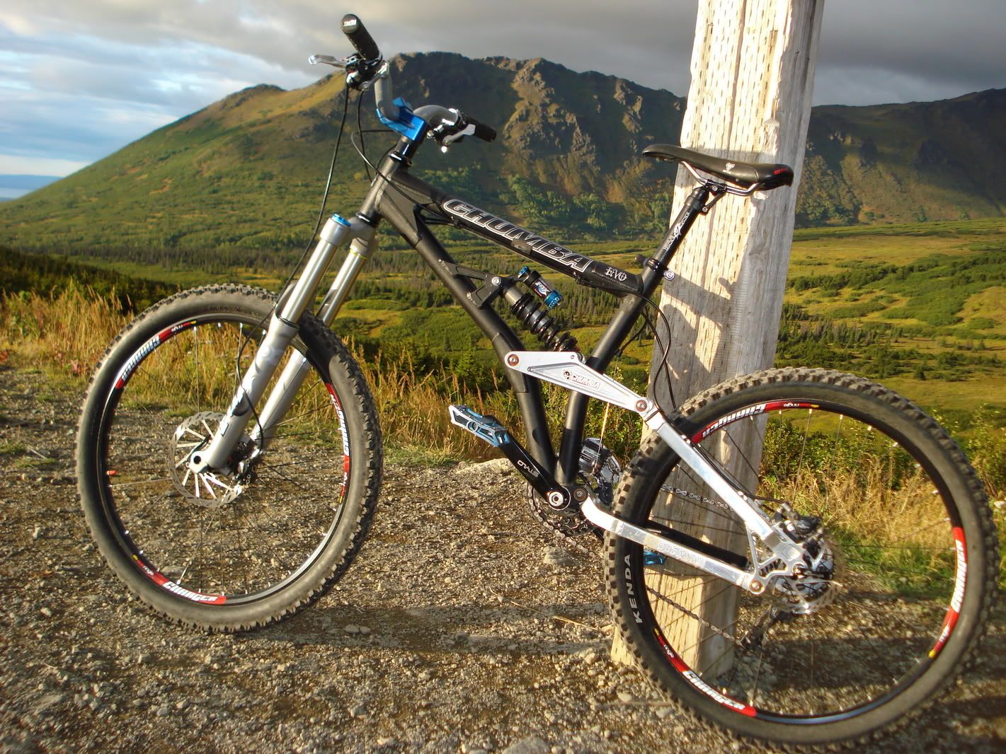

    nojoke
    here it is.....its current config 34.0 lbs

  • 09-03-2009
    tonycan
    That is a smart looking bike! Congratulations!
