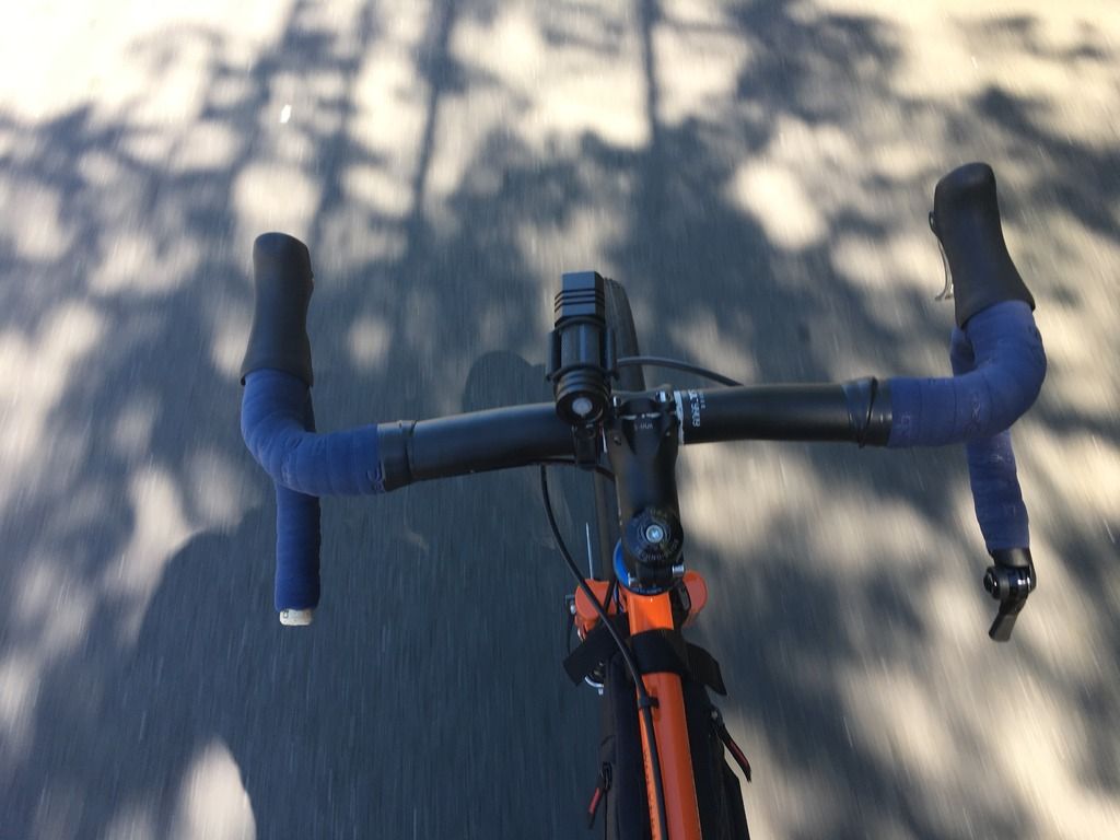

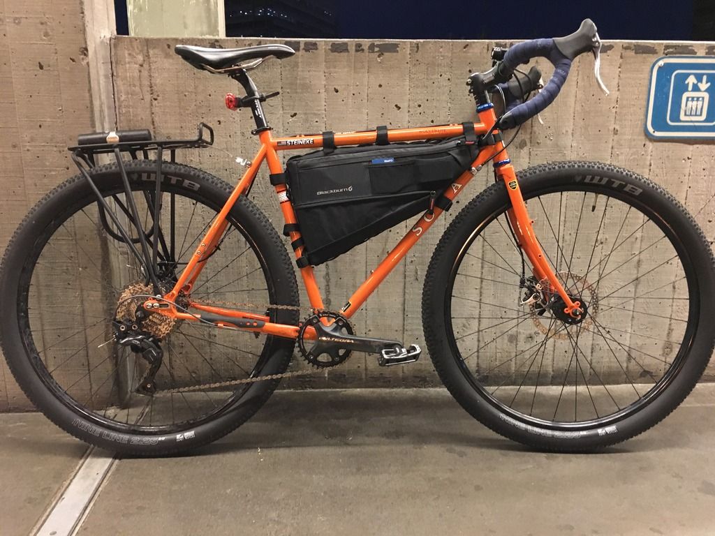

    My current setup
    1x11 with XT rd and Microshift MTB bar end - works perfectly!
    36t Wolftooth chainring, definitely easy to spin out on flat ground, but climbs easy enough.
    Finally got some compressionless housing for the Spyre brakes, and bumped up to a 180mm front rotor, RT56, as specified by Shimano for the pads in the Spyre. Tektro levers work much better with these brakes than 5700 too - I think the Shimano SLR pull ratio is not standard road pull ratio. All in all, it definitely stops well enough, but still nowhere nearly as well as a halfway decent set of hydraulics. Kinda lusting over the new Hylex RS, would love to hear some real reviews, if anyone here has used them.
    I also up-ed the tires, and went with the Nine Lines - super fast big tires, and they ride great with 25psi. Still rocking the WTB i23 with XT hubs, pretty great setup for me. Soaks up all the rough roads Oakland can dish up, with nary a hiccup. Not much room for mud though, and I've been thinking about going with something smaller to be able to slide the axle further forward.
    This bike is pretty much in Commute mode for good now, since I recently bought an MTB to handle off-road duties. Hence the Blackburn rack, to carry my daughter in the baby seat, and the Saint pedals, for easy neighborhood rides.
    Also curious about the new thru-axle fork. I would love to stiffen up the front end, but SOMA claims tire clearance would take a hit - not sure how I feel about that, but I suppose it would probably be fine with a normal size gravel tire, which I will probably switch to when I wear out these Nine Lines. Anyone out there have the new fork installed yet, and if so, how is it? Definitely curious about tire clearance, stiffness compared to the original fork, and overall worthiness - is it worth the $200 plus a new wheel/hub?

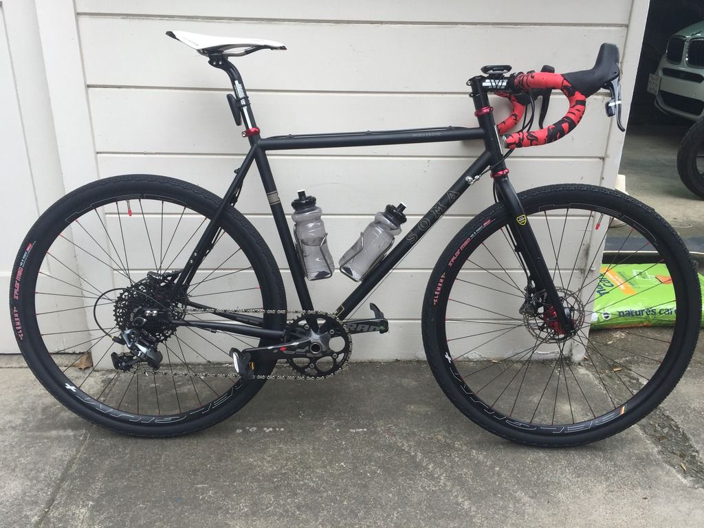

  74. #274
    Mar 2017
    New Soma Wolverine build - loving it!
    Not sure if this pic of my new build posted... but I'm loving her so far!
  75. #275
    Aug 2014
    280
    Quote Originally Posted by rmf17 View Post
    Pic posted - I dig the black and brown theme!

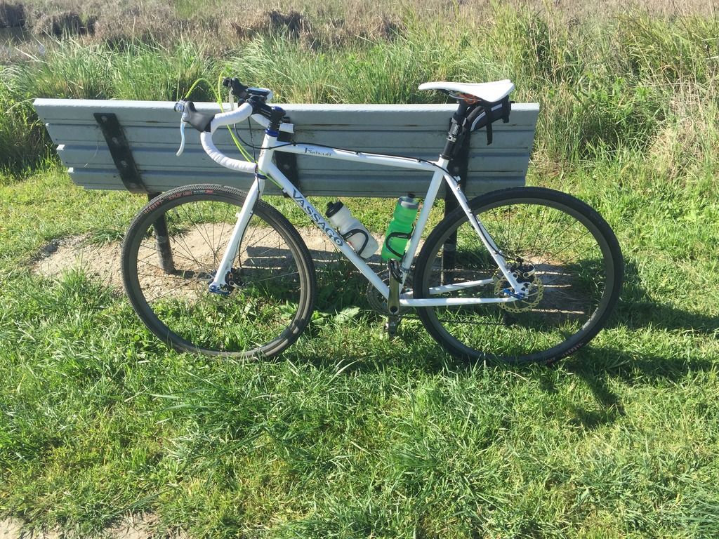

    Here's a pic of the clearance on the thru axle
    IMG_2715.JPG. I have a Steel Vassago Fisticuff with 33cc Clement xplor USH's and skewers front and rear. VS the solid axle (front and rear) Wolverine...I like riding both bikes. The thing that makes it for me are the bigger tires on the Wolverine combined with the solid feed back from the axles when the trail gets some good roll to it it. The Wolverine just feels a bit more well sorted underneath you. That's the.best way to describe it. I've had plenty of epic rides on the Fisticuff too, but it's a little different experience in terms of how solid the ride on the thru axles is....not better, just different. I hope that makes sense. IMG_2714.JPG
    It was about another $70 to switch the Tange drops to the 142x12 Paragon drops and then add the shimano rear axle. (Price for the rear axle and revised Paragon sliding drops). The optional Wolverine fork was on biketiresdirect.com for $189 and it came with the axle. So it is a bit of an out lay to go solid axle vs just keeping it economical and running good old skewers. Another solid axle bike is this Ti Vassago TKO. It will take big tires too but I mostly use this for road riding on 28cc Panaracers. IMG_2707.JPG

    Vassago TKO, this thing can run some large tires too.
  114. #314
    Apr 2017
    9

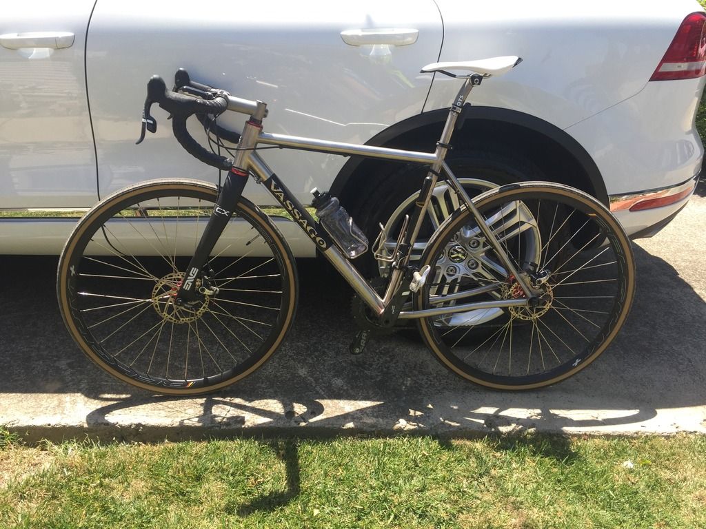

    Fisticuff with 32cc tires---those could be bigger too.
    I'm using the Wolverine steel thru axle fork on the Vassago Donnybrook build. Frames have similar geometry so it should work. The frame some DT Swiss solid rear axle. Should have the frame in a week, I'll post pics of the build.

    Just trying to keep up with wheel standards. I had a tough time finding a qr disc tubeless wheelset appropriate for 40mm+ tires when I built my bike up, but that was also like 2 years ago. Most tubeless disc wheelsets then were for MTB, and therefore thru axle front. The "road" qr disc options that were available then were mostly for actual cross bikes, and mostly tubular, non-tubeless, or not wide enough for tires larger than about 35mm. There were a few exceptions, but those were all ridiculous expensive. Not about to drop $1000+ on a wheelset for this bike.
    I settled on old stock MTB 29er qr wheels - old model XT hubs with i23 rims. A bit over built for anything smaller than a 38mm tire or so, but they best fit the bill.
    I don't really consider the Wolverine a cross bike, either. An off road touring bike, burly drop bar commuter, grocery getter, versatile bike for sure. But cross bike? You could race cross on this bike, but I would prefer something much stiffer with a steeper head tube for cross racing.
    Hence why I also think this bike suits MTB wheels better than road wheels. 15x100 thru axle hubs are going to get rare as the MTB industry moves towards 15x110 boost front axles. Even a lot of XC forks now have 15x110 axles now.
    Plus, with a 15x110 fork, you can still use an adapter/different end caps in most cases to run 15x100 wheels. So, no real reason to not go to a boost front.
    I don't think 12x142 is going to go anywhere though, mostly because boost 148 rear hubs require a different bottom bracket spacing/crankset to get the chain line right.
    So, I'm not saying it's better, per se, just that in future it's going to be easier to get parts for it.
    I could go either way with PF bb. They don't really cause any extra work, don't really require any more maintenance, and allow for a larger bearing set than most other bb types. Larger bearings are always better. But, I think a huge bb shell on a steel bike looks dumb, so for this bike I prefer a standard threaded bb.

    Thank you. Yes yes. Revelate tangle. Perfect fit. I had to lower the rear h20 holder though. The derailleur set up perfect. Other than the extra gear I would not notice a difference. Very smooth.
    Sent from my LG-H901 using Tapatalk

    I'm running the woodchippers. Not as much of a drop and I don't think the 105 levers are quite as long as what you have there. Might be worth looking at other bikes that have them. I think your basket would clear mine. I just put my blackburn handle bar bag with my tent in it and it has enough clearance to shift. Just an FYI

    New Matt Black Build
    So i built my frame up last weekend. it's a 52cm, i'm 173cm but with a 31" inseam and it fits nicely.

    Quote Originally Posted by SteveJfromtheSwitch View Post
ID:	1161903Click image for larger version.
ID:	1161904Click image for larger version.
    Either your 31" inseam is your pants, and not your cycling inseam, or your pelvis has to rock back and forth way too much. Because my cycling inseam is 31.5 and my 52 has WAY less exposed seatpost. And I work in a bike shop and had my fit done. And I just had my fit updated, and my post still isn't that high.
    I lost a bunch of weight, so my flexibility changed.
    Sent from my SM-G930P using Tapatalk
  191. #391
    Feb 2012
    455
    i think the photo is deceptive, it's only a small drop from bars to seat when you look at it side on
  192. #392
    A God Without A Name
    Reputation: Agwan's Avatar
    1,326
    I'm not talking bar drop. Seatpost extension. Your seat looks way too high for a 31 inch leg.
  193. #393
    Feb 2012
    455
    i don't know what to tell you mate, it fits. i don't work in any bike shop but this ain't my first rodeo either
  194. #394
    1,326
    It may fit. If it does your numbers are wrong. That seatpost extension is a hair higher than my wife. Who has almost exactly a 35 inch inseam. She actually enjoys about the same saddle to bar drop as well. She's also had a fitting done. She still rides a 52" (She's the same height as me, just much longer legs and more flexible.)
    I don't care how many rodeo's you've been to. I work at the rodeo, 5 days a week. For nearly three years now.
    Being able to reach the pedals, doesn't mean it fits. You may have an ideal saddle height, and if you do. It just means your cycling inseam isn't 31".
    Or your saddle may be too high, and your pelvis is rocking side to side when you pedal, and you're putting more strain on tendons than you need to. As well as putting extra stress on your man bits.
  195. #395
    Feb 2012
    455
    ok boss, you win,
  196. #396
    1,326
    Not trying to win. More interested in whether or not you're doing something that can sterilize you.
    Basically, I want you and your wife to KEEP winning.
    If your pants inseam is 31, then it all makes sense. My pants inseam is like... 26.5? I dunno. I'm an expert in fixing bikes, not making high performance pants.

    So I fitted a Rawland Raidoverks Rando Rack on the front on my Wolverine today - I can dig it! It's a very sturdy small rack that should hold a basket, small bag, or 6 pack pretty easily.
