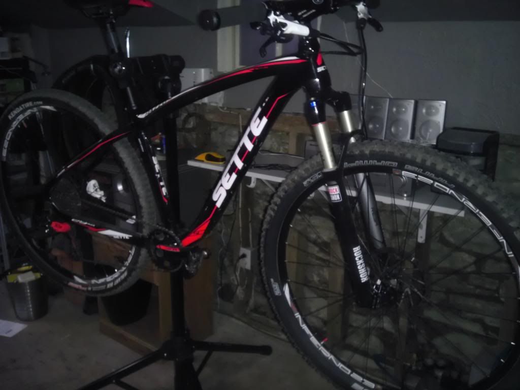

    I love mine. Builds up easily to 23 Lbs or less with real tires, and a real saddle.
    Attached Thumbnails Attached Thumbnails Post Your Carbon Razzo 29ers!-setterazzo-035.jpg

    Nice! Finally a good Pic. At $699.00 might be too hard to pass up. Thanks.
    820
    You won't regret it. Lighter than an Air 9, Internal cable routing (cables stay clean from mud/grit so you probably will only have to change them once a year or less), tapered headtube, direct mount rear brake, external BB (which I wanted), 5 year warranty, two water bottles, and oh let's not forget $1000+ cheaper than the name brand bikes. To me it is a no brainer.

    Here's some excerpts from a XPOST in the 29er forum
    Weight using my digital bathroom scale = 20.2.
    Ride report results:
    Took the bike out for a flogging at South Mountain this morning. I had a blast just hammering it all over the trail. I've owned Aluminum, Steel fand Ti hardtail frames . This is the first carbon Hardtail that I've had and ridden on real dirt trails.
    I'm sold on the ride characteristics of the frame and carbon in general. The frame's damping qualities were excellent. The bike was super solid and stiff when I stood up to sprint or grind up a steep climb. However, on the rough rocky sections it felt like it was damping the vibrations and impacts such that I felt comfortable going even faster through those sections.The bike was spot on from the word go.
    Normally, I get on a new frame and I have to get a feel for it after a few rides but not this time. I felt right at home and I just started hammering it some more. I took it up my favorite climb to the Heli pad and then down one of the sketchiest trails (Goat Trail). No problems or issues and the damped ride was really cool.
    I had heard a lot of people saying that carbon bikes have a dead feeling to them. I can understand that some might say that but in a rock strewn area like Phoenix. That damping is a major asset.
    I am close to selling my Ti Hardtail and buying another one of these to keep as a single speeder.
    I am definitely selling my steel road bike and buying one of their Sette carbon road frames. I'm sold on their products.

    My New Carbon Sette Build
    I just finished my Carbon Sette 29er build and wanted to show it off.
    Frame: Sette Carbon Razzo 29er - 19" matte black
    Fork: Reba RL
    Group: SRAM X7 triggers, derailleurs, & crankset
    Wheelset: Sun Ringle Black Flag Expert
    Brakes: Avid Elixir R
    Bars, Stem, Post: Crank Bros Cobalt 3
    Grips: Sette Lockons
    Pedals: Shimano PD-M424
    Seat: Charge Spoon
    Tires: Maxxis Aspens
    Computer: Cateye Strada Wireless
    Post Your Carbon Razzo 29ers!-2013-02-03-17.56.19.jpgPost Your Carbon Razzo 29ers!-2013-02-03-17.56.06.jpg
    The build turned out great. It's a lot sharper looking than I originally thought it would/could be. It's pretty sexy and weighed in at 24.5lbs as pictured w/out the seatbag.
    Took it on it's first real hard ride today and came away pretty impressed. I'm coming from an alum Airborne Goblin and the difference was noticeable. I climbed the hell out of a few hills that have been giving me trouble on my 2 previous mounts. Not sure if that was due to the weight savings (1.75lbs), the slightly different body position/geometry, or just the adrenaline of pushing a new bike. I crash over some pretty heavy roots on my home trail and all of that felt very muted as compared to my alum frame. My alum frame was pretty jarring over some of my typical sections and I felt none of that today on the new carbon ride. Front wheel on the Sette wasn't as easy to pop off the ground which can be good and bad depending on situation. The bike was really grounded and connected on some of the hairier downhills drops we have. Once I got comfortable, it felt like I was twisting and turning through the woody tight singletrack faster than usual and on the field straights I was hitting 16-18mph on the computer.
    Overall very pleased with the $400 used carbon frame.

    My Razzo build
    Here's my build.
    19in Frame
    1x10 XT with Raceface 33th chainring
    Fox 100mm with remote CTD
    Avid elixir 7 brakes
    Time pedals
    Ritchey cockpit
    San Marco seat
    DT Swiss wheels
    Bathroom scale 22 lbs
  104. #104
    801
    Quote Originally Posted by Armando75 View Post
    Here's my build.
    19in Frame
    Time pedals
    Ritchey cockpit
    San Marco seat
    DT Swiss wheels
    Sharp looking bike. What size stem and how tall are you?
    Any idea on how much steerer tube you ended up using? I want to get the carbon frame but fear the steerer from my al razzo will leave me a hair short
  105. #105
    Apr 2013
    17
    It's 5'11 and I currently have a 100mm stem with a flat bar. I'm going to change the bar to a 1in rise carbon bar.
