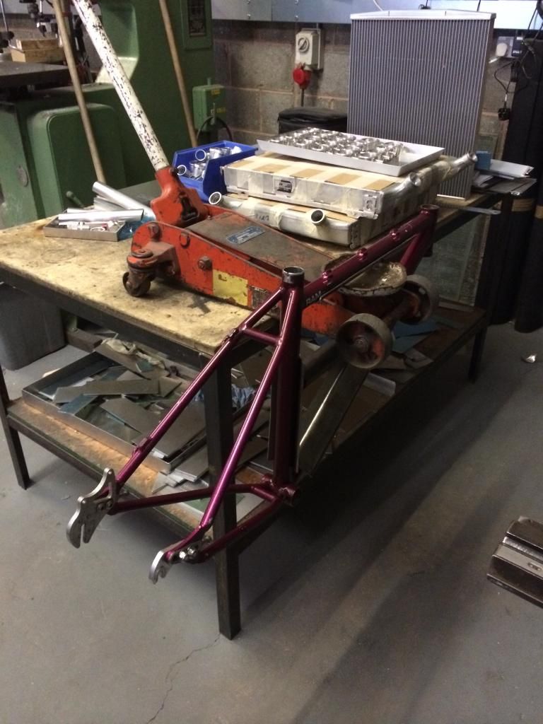

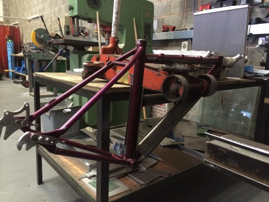

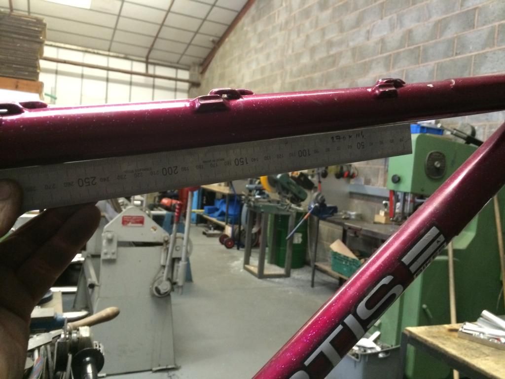

    What the pictures in the ebay listing don't show, is that because there are so many weld on cable guides on the top tube, the tube is actually ever so slightly bent. It was really hard to photograph, but easily noticeable in person.
    I knew this, I spotted it he day I first saw the bike, and have been ribbing him ever since. I also knew that it was repairable, but its really difficult to get the noisy tools out on something that has cost so much money. Not so difficult for me.
    Difficult to make out from the pics, but I made up a fixture that would allow me to jack the frame slightly, I needed to spread the load as widely as I could so as not to damage the frame anywhere else.
    Done. There is a fraction of a millimetre now front to back with a straight edge, not something that you can detect with the naked eye.

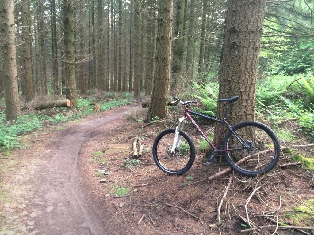

    Fitted an on-one 17t sprocket yesterday, and had to make my own spacers. Simple maths got it perfect.
    First proper off road ride last night, tried the blue at the fod. It's been a long time since I've ridden a single speed off road and it showed. Huge amounts of fun tho, I was able to tell it on some of the faster technical sections without worrying what gear I was in or if the chain would drop off.
    Front end could do with being a little sharper, I might drop the travel to 130mm to see if that helps.
