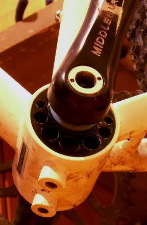

    I had this bike for a week or 2, and I just got a chance to ride mine today. Got in a good 2.5 hour ride on mixed conditions. The bike has a good feel to it, not nearly as springy as my SIR Niner but just feels nice and solid. BB are has very little flex. Handling was good felt nice at high speeds, Tight single track seemed a little better than my Rig, but not as quick steering as the Niner. I had NO problems hoisting the front end up. I like the playful feel of this bike kinda felt like a Inbred I demoed for a week . Geometry is pretty good by my standards. Cable guides leave a little to be desired and the downtube clearance is depressing. I still had to do a little filing on the tab to get it to clear with the BIG race. For $250.00 sheckles this is a nice frame with a good solid ride quality.I call it a good deal. I think it would seve big boys well also. I thought this build would come in a little lighter but I don't guess it is too bad.
    Sorry for the dirty pictures, We see way too many spotless bikes.
    Bike specs: 24.8lbs, Medium Frame
    Specialized Resolution Tires converted to Stans
    Bontrager Rims
    CHris King Hubs
    14/15 Dt spokes
    Alloy Nips
    Sram PC 68 Chain
    Boone 19 rear cog
    Surly 32 ring
    Old White Industries 5 arm cranks ( Great Find)
    Un 72 BB
    Hayes HFX 9 Brakes w/ Avid rotors
    Mary Bars
    Oury Grips
    King Headset w/ 7mm Ventanna race (4mm won't clear)
    Reba set @ 80 mm
    Salsa Clamp
    RaceFace Post
    WTB Laser She saddle Ti Rails
    Thompson 100 mm stem
    What did you use for inserts?
  • 01-09-2007
    Enoch
    I used old inner tube, then I gave the guides a little squeeze with some non maring pliers. Another fine quality of steel. :D

    ajbuilder
    any noise from the eccentric? quality observations?
  • 01-10-2007
    Enoch
    None, but then I have had 4 bikes w/ ebbs' and have NEVER had a problem noise.

    How you liking those middleburns? Other than the incredible wear marks from ONE real ride!
    Wondering if I gain anything going from Truvative SS cranks other than Bling?
    As far as stiffness goes I can't tell the difference between the Middleburns and the Race Face X-Types I had on the Dean. I knew I'd be getting some wear marks on the black cranks, but no matter. I have a bit of an inward heel thing, and if you add a little mud you get a sanding block. At least it's not carbon.
    If your Truvativs are X-Type I would think you would lose the bearing drag. At the very least I know I don't have to carry chainring bolts when I go riding.

    Enel
    Just got my Zion EBB frame.
    Medium weighs 5.35 lbs with headset and seatpost clamp...about the same as the Monkey it's replacing.
    I'm trying the Cane Creek extended lower cup..I'll let you know about Reba Clearance, but I am not hopeful.:rolleyes:
  • 01-10-2007
    Enel
    Okay:
    The Reba/fork clearance is a total joke.
    Even with the tall Cane Creek lower cup, I had to remove the (non-poplock just like Enoch's) top cap to get it not to hit. There is no way I could grind enough to get it to fit. Even with the whole cap off, I still had to shave the plastic down a little bit.
    Luckily, the lockout still works, I just don't have the cool blue lever to turn.
    Rides nicely in my short demo in the front yard. Seems like a Monkey with dropouts that are a lot more disk friendly.
    Any idea how tight to torque the EBB set screws? Really tight, or just barely?

    mallen
    I use a little blue loctite on the bolts. Works both as an anti-seize and a lock. I have also got in the habit of using loctite on the chain ring bolts as soon as I buy a crankset.

    rockhound
    They make hose guide inserts for those brazeons...my Giant used them too.
    Enoch, do you mind if I ask how tall you are and what your inseam is? I am trying to decide between a small and a medium.

  • 01-11-2007
    wilks
    I am wanting to pull the trigger on a Zion 29er and run it with a suspension fork - this fork clearance thing bugs me though - what 80mm travel 29er fork has the lowest a-c and the least sticky out knobs? I would be on a medium FWIW. Thanks.
  • 01-12-2007
    Enoch
    White Bros fork has a shorte AC and the controls are flush. I'm going to try my 100mm WB on this bike. It isn't much longer than a Reba @ 80.
  • 01-12-2007
    wilks
    I am sure you will post the results - thanks for the info!
  • 02-01-2007
    cycljunkie
    Did you try your WB on your Zion yet? Just curious how it felt.
  • 02-01-2007
    Enoch
    We put my 80mm Magic on my friends large frame Zion. He really likes the way it handles but unfortunately it still hits the down tube. The good news is it will clear with the small (4mm) Ventanna race opposed to the Reba which barely makes it with the 7mm.
    I have yet to Put my 100 on mine, but I can just about bet it will be a nice adition.
  • 02-03-2007
    cycljunkie
    Does the 7mm helper race creak or add flex? I'm going to run an 80mm Reba SL with the lockout cap (no poploc) so the 7mm race along with a file to the cap should do it right?
  • 02-03-2007
    Enoch
    That should do it. I don't think you wil notice a thing except a little higher hand position. I guess it does slacken out the head angle abit, but the bike is still just fine. As far as geometry and handling goes for the Zion, I personnally would not change one angle or tube length( Except the fork clearance problem).
  • 04-14-2007
    EAutry
    Enoch took my Niner One 9, and let me ride his Zion 737 gearie for about a mile or two of trail today. My Niner frame @ $750, Zion @ $250...best 29r deal on the planet as far as I'm concerned. Love my scandium Niner SS, but the Zion rode so good, if I had it to do over, I may have just bought two Zion SS frames, and saved myself the trouble of swapping out rear cogs:)
    I feel much better about my decision to order the geared 737 last week, sight unseen. Geometry is really close to the Niner...but for the money, the Zion wins handsdown. At $250, who cares if it comes in a pound and half or so more than Niner...I'll go on a little diet or something..
  • 04-14-2007
    Enel
    I'll add a little update as well.
    I have been going back and forth between the
    Ventana and Zion for SS rides. They each have their strong points. I have found only one flaw in the Zion that bugged me, and I noticed it only while riding rigid....frame flex.
    Riding the Zion and Ventana back to back with the same set up and same Zion fork, I found the Zion to be more comfortable, but more squirrelly, especially as the speeds and stress increased. The flex was most noticable when diving into fast downhill switchbacks under heavy braking at speed. Otherwise, at lower speeds and more casual riding situations, I prefer the comfort of the Zion.
    After going back to back a lot, I prefer the slacker steering of the Ventana over all.
    I now have the Ventana set up rigid with the Zion fork for smoother/faster rides with higher gearing, and the Zion set up with suspension fork, and lower gearing for rougher and more technical rides.
