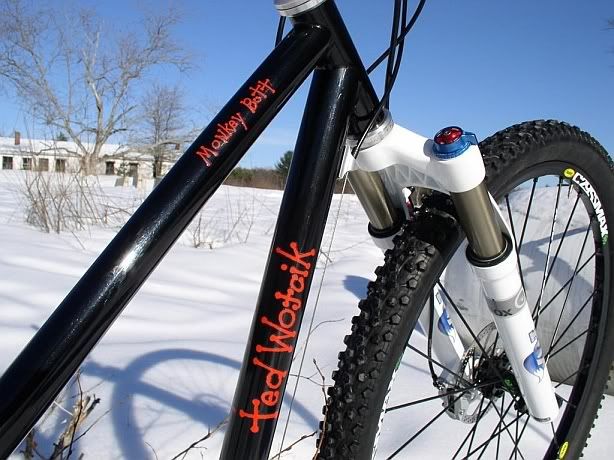

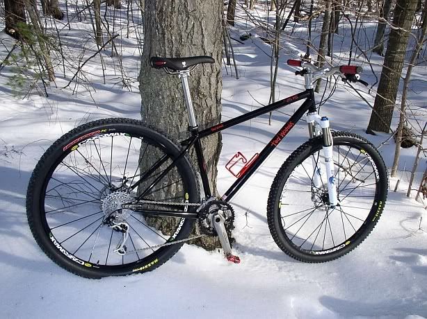

    On Saturday I met Ted Wojcik www.tedwojcikcustombicycles.com and his wife Susan and their cute dog Daisy and picked up Ted's latest hardtail design - a 29er labeled the "Monkey Butt." This frame was build with help from input from members on the www.ridemonkey.com 29er forum (where I moderate) and with a goal of building a 29er hardtail that could fit a front derailleur with ample tire clearance while providing the frame with short chainstays - with a focus on East Coast Trails. Ted took input from forum members and applied his years of frame building skills and expertise to come up with this new 29er. The name is partly due to the origin of the frame - ridemonkey.com - but also a little bit of a pun on "butted tubing" used in the build.

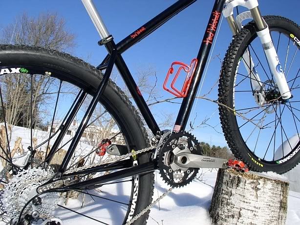

    This bike features a fairly steep HT angle, and short stays utilizing paragon sliding dropouts, along with an e-type front derailleur. Currently the rear stays are at 17.2" with a fully geared set up, but if you were to run a 1x8 or 1x9 or single speed set up you could run a nice sized tire with sub 17" chainstays. The set up makes for a quick and nimble and highly responsive 29er hardtail.
    Ted spec'd the bike with a Fox F29 fork and a mix of Shimano XT and LX components. The wheels were provided by Mavic, and Mavic will receive this bike for riding and testing.
