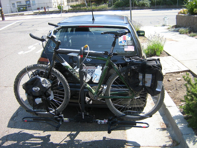

    Its my old 2000 Giant Yukon. I dumped the stock craptastic suspension fork and went with a Voodoo Rigid fork. Also, the brakes are LX V brakes, some mystery brand high riser bar, Rockshox suspension post, Panaracer 1.5" slick tires, older 74/110 LX cranks with 26/36/48 rings and LX derailleur. I topper her off with a Performance front rack, an Axiom rear rack, some mystery ebay find rear bags and Trans-It front bags.
    I've also used it for pulling my kid in the Burly trailer.
    I've already saved 90 miles on my car from running to and from the little grocery store on this thing.
    As far as the low rent components go, often they last longer. Low rent cranks typically have all steel rings, which last a long time. The stuff is made less around being lightweight. Just remember to keep the drivetrain well lubed and the derailleur pulleys clean.
    Fenders rule. Get yourself a good hiking or biking rain coat and rain gear and go do errands in the rain.
