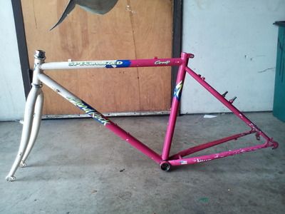

    I had been browsing Craigslist for almost two weeks. I found the bike I had been wanting to get as a commuter for $80, it's a mid-90's to late-90s Specialized Hardrock according the guy who sold it to me. Luckily, it happened to be a LBS owner and he had changed out the bottom bracket since it had broken when he received the bike. But, anyway, I am going to build it up and hopefully have one of the better looking bikes on campus (even if it is old).
    I want to do upgrades to it since a lot components are rusted a bit and I am stripping it down to give it a fresh coat of paint and to battle off tiny rust marks on the steel frame. Anyway, I took it apart today and this is a better image of the frame and fork:
    I want to change out the most of the bike to turn it into a commuter one. I am debating if I should keep the mountain bike tires or not. But anyway, can you guys suggest anything to turn this old bike into a commuter? The frame size is a 17.5" and that's all I know. A lot of the parts that came on the bike are still the original parts but I think it's time it received a complete change. Any recommendations on what I should change out and add? This is my first build up of a bike I have ever done. So I am looking forward to it!

    Looks great! Should make a fine commuter. I'd put it back together, tune it up, replace what needs replacing, and ride it for a while. Then you can decide what changes you'd want to make. It has eyelets for fenders/rack so I'd put those on the shopping list if applicable.

    Personally, I like those classic, almost tacky paint schemes, and would touch it up if possible, but to each his/her own. The most likely candidates to have actually worn out (but but not necessarily) are the chain, front chainrings, and rear cogs. The other stuff often keeps working fine even when old. New brake pads will make a huge difference, the old ones get brittle.

    I would have loved to have kept the pink and white/light pink color on the the bike but on the side that is in the image, you can't see it but there was a huge spot that had nothing but bare steel showing on the other side. Plus the numerous amounts of rust spots, so I stripped the paint down yesterday and today i got down to trying to get the remaining pieces of paint left on the bike. Sanding a bike is not easy, hopefully I will have it done tomorrow so I can take it around to a few body shops and see how much they would charge to do just a flat white color on it. I would do it on my own but I am horrible in doing painting. If it comes out to be more than at $60-70 I am going to just paint it myself.

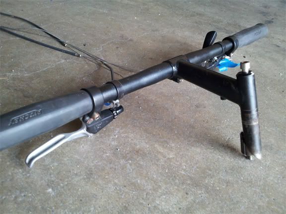

    I am going to start the painting today but this morning as I was taking the frame to my shop to work on it there, I noticed that the handlebars are actually shorter than the ones I have on my other bikes, so I am going to look into replacing them since they aren't as comfortable plus I like a little rise to my bars. But I just don't know what the size of the stem is or if I can just replace the whole thing to accommodate a handlebar a littler wider.
    It seems like the stem is welded with the other piece, is there a way I can replace the whole thing or something?
    Short-Change-Hero
    Reputation: gregnash's Avatar
    6,412
    That is actually a quill stem, I am thinking maybe 1" threaded. Bars are probably pretty small either 25.4 or 26.0mm.
    Reputation: ymduhh's Avatar
    135
    Is there a way to replace the whole thing so I can fit bigger bars on it? Since I will using this bike for my commuting the small bars would be kind of uncomfortable.
    Reputation: marpilli's Avatar
    3,993
    You shouldn't need to replace the whole thing.
    Remove the grips (google or search MTBR for ways to remove grips if you don't want to cut them off - I use WD-40). Loosen the brake and shifter levers (yellow circles) and remove them. Then, loosen the stem (green circle) and remove the handlebar.
    Take the handlebar to a local bike shop and they will measure the diameter for you so you'll know what to buy. Purchase new handlebar that is longer and has a "rise" to it.
    Reverse procedure to install the new bar.
    Also, tell the bike shop this will be a commuter. Maybe they have a bar that also has some "sweep" to it that might be more comfortable.
    135
    awesome, thanks for the diagram. I pulled the bar off and will be taking it to the LBS in my area for measurement, so I can pick up a new bar.
