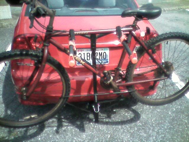

    o and this is the only pic i have before i started to break it down.
    sorry for the bad cell phone quality all i have is a gZone boulder

    Stick to 26" Wheels - 700c's wont work (as stated above). The bike that they are on is a Road frame (I have an '85 400 and LOVE it, still runing 27" wheels though), you have a mountain frame.
