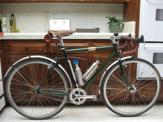

    I have this bike and wish to convert it over to a flat bar, urban commuter. It looks a bit different since this photo was taken but it's basically the same. I have a new Easton carbon high rise bar, Avid BB7 mtn bike brake calipers, Paul levers and have ordered Shimano 10 speed shifters. What I don't know is: How much longer will the stem need to be and should I use the riser bar or try a straight bar? I know there is no formula to this change and much of it is personal preference. However, I'm sure many folks have made a similar switch and may be able to share some of the changes that they made. Any advise would be helpful.

    One thing to keep in mind is that drop bar bikes typically have shorter top tubes. You may need to use a longer stem to compensate for this, though the riser bar may help some (albeit, giving you a more upright stance). As to how much longer of a stem you'll need, that depends on the exact geometries of your bike and personal preference. I would say, build it with the stem you have now and ride it around some. If it feels too cramped or puts you in more of an upright position than you'd prefer, then you need a longer stem.

    I would Definitely put a longer stem something like a 120. And a Flat Bar
    This had a Drop Bar on it then I converted it into a Urban Hipster SS

    Love the Bianchi!
