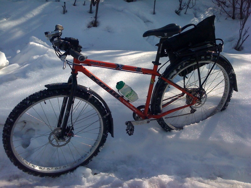

    Winter mode(Nokians on SnoCats):

    Winter wheels with studded tires? Suspension fork to swap in, too for some weekend fun?
    Love the almost-too-fat-to-fit look. Orange is a great traffic color, too. I want one. :thumbsup:

    Couple of notes on build:
    The PB fenders fit the Unit great, both the bridges on the seat and chain stays are threaded, and fork has a hole pre-drilled. I did use an inch or so of plumbers tape to lower the front fender closer to the tire.
    PB disc rack required some extras and mods to fit level. Went to Lowes for conduit clamps that fit over the seat-stays for the upper rack mounts, also notched out the bracket for the upper mount to bring it further forward allow it to sit level.
