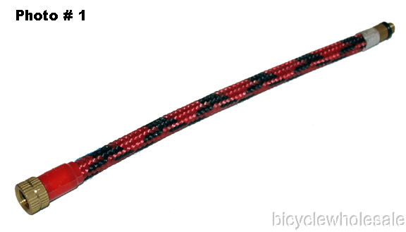

    I found a similar adapter on eBay.
    Bicycle Pump Hose Schrader 6 1/2" Replacement Hose | eBay
    It may be just as much fun to make one yourself however. The hardest thing to find would probably be a tire chuck that screws onto the valve. But you could always just cut the hose off of an old floor pump and add an air compressor nipple.

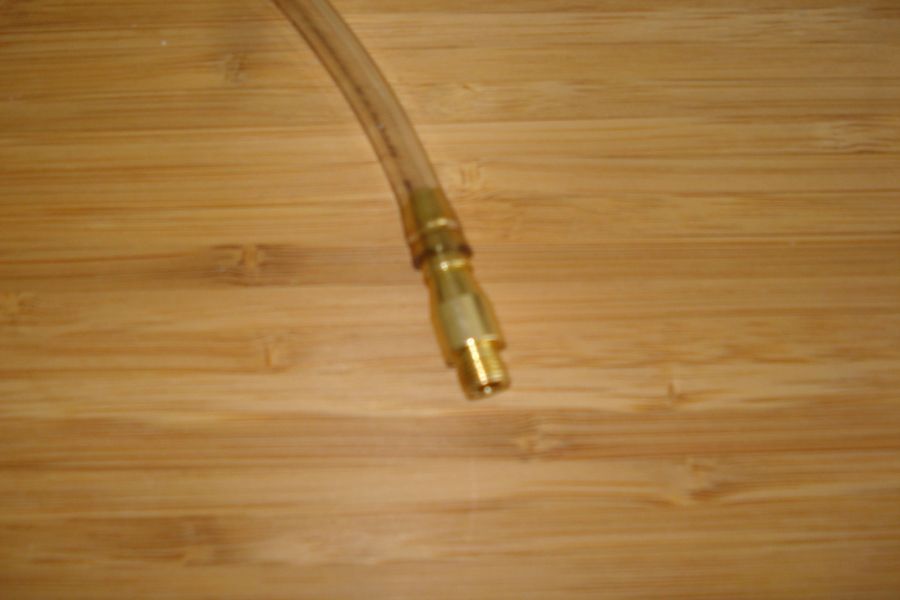

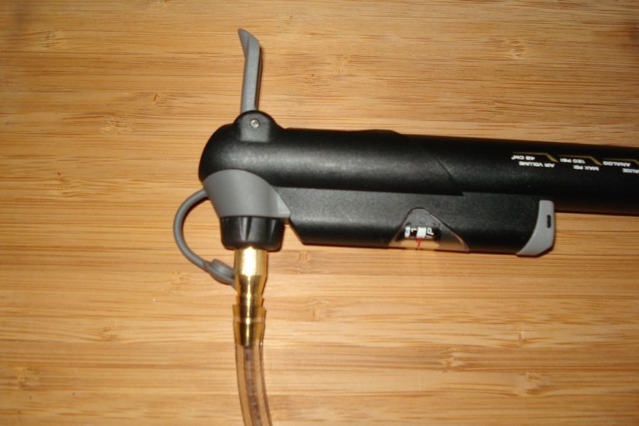

    Step 2 & 3 Complete
    I went to the hardware store and now see where the confusion came from in my earlier post. I didn't realize how big the fitting that I posted earlier really was. I was thinking that the threaded part of the fitting was roughly the same size as the valve of a schrader valve.
    However, I found a fitting that may work. I bought a $3 compressor inflation kit which came with a tapered inflation nozzle. I also bought a foot long section of vinyl tube (5/16"OD x 3/16"ID) for 21. I put those together and below is what I have so far. Now I'm just waiting on the pump head to arrive in the mail to find out if this will work.
    tapered inflation nozzle & vinyl tube
    tapered inflation nozzle inserted into bicycle pump
    I'm able to get about 60 psi into the vinyl tube by putting my thumb over the open end and pumping, but air starts to escape from where my thumb is as I continue to pump.

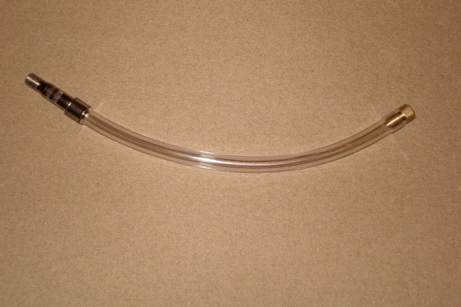

    Advances in Research and Development
    I've created the perfect pump tube for tires with presta valves.
    The tube consists of a valve extension from the auto part store, a 3/8" OD x 1/4" ID vinyl tube from the home improvement store, and a presta valve adapter. It was a pain in the butt to get the unthreaded end of the valve extension into the tube, but I finally got it.
    A tube for schrader valves could easily be created by using a valve extension on each end of the tube (the valve extensions come in a pack of 4). The only modification that would need to be made is to jam something down the valve extension on the tire side of the tube to keep the valve depressor thingy in the down position. Or I can wait until the pump head that I ordered arives and I can put that on the tire end of the tube.
