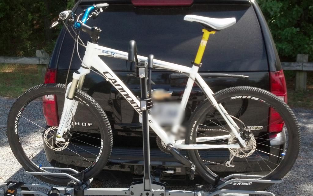

    Here is a quick pic of the bike before my ride this afternoon.
    It was a nice day for a ride, 85 with clear skies.
    I softened the rebound and compression of the fork, and about half way into the ride I moved the saddle up another quarter inch. I also set the tire pressure to 28psi Over all the bike rode a bit better and my wrists didn't start to bother me until about mile 10.

    I have the same bike. I am 6'3" fairly equally proportioned arms, legs and torso. Stem height is to low with seat at correct height on a Jumbo frame. At 6'4" I think your frame size is to small. Based on your pain complaints I think your headtube is too short. I don't think seat adjustment can fix this issue or stem height because you will then be moving your knee at 3:00 position to far back (which could cause knee pain or worse). You might reduce lower back pain with the bar change but your likely going to continue to have pain issues. I wouldn't risk it and would sell and get a bike frame properly sized for you.
