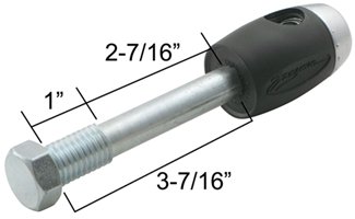

    You obviously never used...
    Quote Originally Posted by qqfob
    Hitch mount may seem safe, but all it really has is 1 point to mount on, held on with just a pin through 2 squared bits with plenty of play. And the rest of it is pretty much wheel mounted hardware. Again, lots of wobble.
    ... a good hitch rack. My rack has a threaded bolt for a hitch pin. Snug it up and no wobble at all.... not that wobble makes any difference anyway. It's just annoying. I've seen a few roof racks pop off the tracks and end up in the ditch with the bikes still attached, but I have never seen a hitch rack failure.
    Something like this:
    Mine is a pretty cheapo bike rack, and even it has this. Instead of the nice lock on the end, my rack has a cotter pin to keep it from totally falling out (or turning to unscrew, since the cotter pin hits something first anyway) if it came loose and unscrewed itself... which it won't because it has a split washer.
    If you can pull 200 pounds of tongue and 1500 pounds of weight yanking and pushing over and over, I think it can handle 30 pounds of rack and 60 pounds of bikes. I mean think about it. What holds the roof rack rack on? Little tiny clips, little tiny brackets, little tiny hooks, all stamped out of 14Ga sheet metal. Yeah, it is held on at four points instead of one point, but those four points are not redundant. If any one of those 4 points fails, the rack comes off. So in theory, it actually has four times the chances of failing.
    Photo Credit: NoGearsHere
    I'm not trying to scare you, I'm just saying that hitch racks are perfectly safe... like anything else... if used properly.
