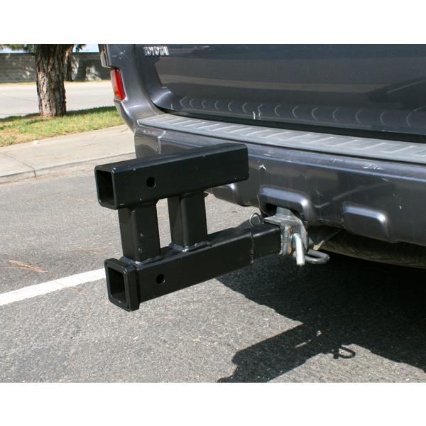

    Have you tried using a double receiver?

    I have one for my kuat rack, which will not fit folded down with bikes. As it is, even folded up, clearance is too tight for comfort.

    Seeing this on my computer in full size at this point, no way would I cobble together some crap like that.
    There are FOUR hitch pins in that arrangement. The extensions on the back of that van...ugh. And honestly, that STILL wouldn't provide enough space for my Kuat NV platform rack to be used to hold bikes between my teardrop trailer and tow vehicle. Not to mention, Kuat is pretty emphatic about not using it with extensions. I have more detail with more pictures in a different thread about the trailer itself. The trailer builder is looking into some options for me that might do what I want without going all Beverly Hillbillies with adapters and extensions.

    To be clear, it's not an arrangement I'd ever use (seems like a lot of leverage weighing on that receiver) but if it works for someone else, who's to say different?

    Never said it doesn't work, just dangerous possibly, but more so illegal in some places due to the dangers.
    In his case I doubt that trailer and everything is half the capacity of his hitch, so probably ok. The only "why?" Moment im having with it is all the pins. Use the bolt versions beyond the interface with the receiver so it's solid.

    As I understand it, tongue extensions drop the tongue weight rating of hitches pretty substantially. I doubt the tongue rating on that particular arrangement is terribly high. Probably higher than what I have on my Subie, but not by a lot. Depends on the trailer that's behind it, but I'll bet with the sheer amount of extensions here, even a small trailer would exceed the safety margin.

    The extensions don't increase the load on the rack at all, only the load on the car frame. Even then, tongue weight is all about how you load the trailer. The tongue weight rating for the car will stay the same, but how you load the trailer will have an exaggerated effect on tongue weight due to the leverage of the extensions.
    I agree that for 1 or 2 bikes it's overkill and better to go with a hatch/trunk mounted rack for that, but for someone with a ~5 bike hitch rack, it might be a worthy option. I see your double receiver is a dual ball hitch/receiver though, so you can't really add an extension to it to get the clearance.
    The owner of the Beverly Hillbillies Extension originally had his setup like yours.

    but he added the extension after wrecking his propane tank (shroud?) while backing up.
    Dual Receiver Hitch for bike rack | Unofficial Camp-Inn Forum

    Per my repeated attempts at getting people to understand how tongue ratings work, if you calculate out the torque angle on that hillbilly extension, I can guarantee he's exceeded his tongue rating. With two extensions, he's probably lost more than 2/3 of the receiver's capacity. He's also likely doubled the load on his rear suspension.
    A receiver's weight rating isn't with the load being applied 'wherever'. It's with the load being applied to the ball on a short drawbar. If that ball sits 12" from the load bearing crossbar (of the receiver), and you add an extension that doubles that distance, you can only put half as much weight on it as the receiver is rated. 300lbs at 2ft applies the same force as 600lbs at 1ft. Simple math.
    If you buy a trailer with a tongue so short that something attached to it does not clear the side of your vehicle when the trailer is at 90º, you are going to smash your vehicle and trailer, it's only a matter of time. I've tapped my trailer's bar against the bumper a few times backing into a 90º, not one scratch.

    So how would you figure it... first subtract the weight of the receiver adapters/extensions/rack/bikes, then what you're left with gets divided by how much further the extension is compared to the distance between rear wheels and vehicle receiver? So if distance between rear wheels and vehicle reciver is 2 feet, and you add 2 feet of extension, your ball hitch rating is halved?
    EDIT: found this calculator Extended Hitch Calc
    Seems people tend to use weight distribution hitches with extensions...
    Wonder what the derating factor is on this setup?
    Yeah!
    Reputation: Flamingtaco's Avatar
    Mar 2012
    1,453
    I wouldn't bother with weight of extensions/adaptors. Too light to be of significance.
    The tongue weight rating protects the hitch from torque forces against the weakest junction, which should be the attachment of the receiver tube to the cross bar. As there is no standardization (receiver tubes can be of varying length and thickness, like this vs this), I err on the side of caution by using the length of a standard 2" drop bar (11.5"), and make it an even foot. Yes, the ball isn't at the end of the draw bar, but the draw bar also does not reach the crossbar in most hitches.
    So, yes, if you add a 1ft extension (2ft combined length, or 2x distance), 100lbs on the extended ball is 200lbs of force. If you add a 2ft extension, 100lbs is 300lbs force.
    In the image of that double extension, the bike is about three feet further out, or 4x. If it weighs 25Lbs, it's applying 100lbs of force.
    So, also yes, you have to take into account the torque applied by bikes when they are mounted to the receiver. It's better s better to mount them to the trailer where they can at most increase the tongue weight.
    Last year I calculated the torque applied by maxing out a 1upUSA HD rack (50lbs in all four positions) and found that a class III/IV hitch (most common) could be overloaded.
    Know the forces applied to your receiver, and stay well within limits, you get to avoid this.

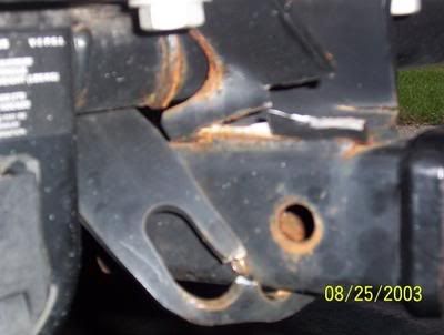

    This sort of failure is probably the kind of thing you're likely to get by going Beverley Hillbilly with extensions and adapters. In my Google search, I turned up a recall on 2002 GM vehicles for poor hitches, so a lot of what I turned up was related to that. This one might, too. I just can't tell.
    Then there's this failure, which is a little bit different, but is relevant because people (who don't know what they're talking about) keep suggesting I put a hitch receiver on the back of my trailer to haul bikes. Yeah, no thanks. Most bike rack companies have strong language in the manuals about installing behind trailers or RV's, mostly due to overhang and additional bounce. I have seen some reports that tongue weights on vehicles that are otherwise properly loaded can spike WELL above the actual tongue rating under certain conditions due to that extra bounce behind RV's and trailers. I found a website for a product called a Trailer Toad (designed mostly for RV's towing large enclosed trailers) where the goal is to protect against these tongue weight spikes on normal freeway driving that damage the structure of the whole motor coach. They made a claim that they were seeing tongue weight spikes in excess of 5,000lbs on occasion in freeway driving (I have no idea what the static tongue weight of the trailer in question was, but they claimed that this happened on freeway overpass transitions).
    So yeah, I'd love it if there was a way that the trailer builder could add a 2" receiver on the front of the trailer so I could bring the unloaded rack along without using extensions/adapters.
