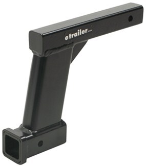

    I think I've found a solution. I spoke to 1up USA and they're comfortable with their rack being used offroad. To improve rack ground clearance, I can attach the Roadmaster High-Low adapter to the hitch receiver and increase the bike rack height, up to an additional 10".
    Roadmaster High-Low Hitch Adapter
    1up USA Quik-Rack
