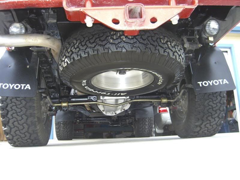

    Race Ready Rig <------Name, ROCKY
    Platform 83 Toyota pickup longbed:
    Final crawl ratio is 215:1
    Professional built Chevy V-8 small block 400 Stroked (6.7 Liter 406) estimated 400hp . Rods are longer than stock at 6-inch length. Edelbrock Pro-Flow Multi-Port Sequential Fuel Injection has keypad in cab for adjustments on the fly. Trick Flo aluminum cylinder heads. Custom Erson cam shaft w/steetdampr. Crowler Roller lifters and roller rocker arms. Evans waterless NPG+ coolant with total bypass thermostat. Power Steering. Air Conditioning. R & M heat exchanger hot water shower system. Premier Power welder and power supply with 160 AMP alternator, Tilton High Torque Starter … . Engine temperature runs cool (198 degrees with a 195 bypass T stat). Headman headers tight fit with heat coat,, Knock sensor, Audiovox Electronic Cruise Control. Hand throttle on transmission shifter, power steering,Jacobs electronics headlamp brightners,Dual optima battery w/marine battery switch, dual transfer cases JP eater,Final crawl ratio is 215:1, NV4500 5 speed tranny, Moser 1.5 inch 35 spline axles, arb rear locker, Tru-Trac gear proportional locker, disc brake upgrade with Land Cruiser vented rotors and 4-Runner big caliper disc brakes. Toyota Land Cruiser brake master cylinder and clutch master cylinder,13.5-gallon gravity flow to main tank under the spare tire, carries 30 gallons of gas and gets 15mpg at 75-80 mph, Custom-made National Springs on all 4 corners, Warn 8000-pound winch, four wheel camper ranger model, 6 underbody rock lights, Rancho 9000 5-way adjustable shocks. Front and rear sway bars with quick disconnects, Firestone Ride-Rite air compressor,Hella twin trumpet air horn,solid rock sliders, bomb proof Renuel custom bumpers, dyno mat cab, Tires are BF Goodrich 33x12.5x15
