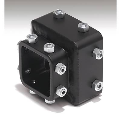

    Make one of these!
    Surco AS100 - Surco Eliminator Anti-Rattle Kits - Overview - SummitRacing.com
    37
    Quote Originally Posted by jtmartino View Post
    Does the large square with screws clamp onto the tow hitch's rim, while the smaller square screws onto the bike carrier's 2" bar? Seems doable, and a pain to use.
    I just had a plan of welding a thin sliver of steel onto the sides, and then sanding it down to sit flush with the hitch. We'll see though. Thanks for the link, It has span wed some new ideas.
    Hi.
    Reputation: jtmartino's Avatar
    3,860
    Quote Originally Posted by iggibar View Post
    Right. They work quite well, but you don't need that many bolts. You can get away with just two on one side to put pressure in a single direction.
    Reputation: JustMtnB44's Avatar
    Nov 2004
    698
    An even simpler solution, and what I have done to my hitch, is just drill and tap a 3/8" or M10 hole in one or two sides of the receiver tube. Then you just slide in your rack, put the pin in place, and tighten down the bolt to eliminate the play. Only one or two bolts to mess with this way.
    I generally would try to stay away from solutions like that because it will not eliminate all the play/wobble, but it will make getting the rack in and out more difficult. And if things rust over time, it will get even harder to use.

    Quote Originally Posted by JustMtnB44 View Post
    Yep that's a great call. I have the same thing on my Thule T2.
