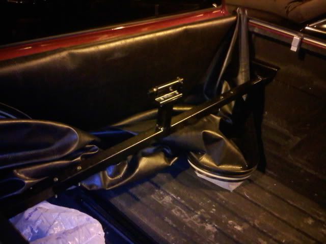

    Check out my new bike rack!
    I quickly realized that tearing the front and somtimes the rear wheels off of my girlfriend and my bike was not going to work. It tears them up sliding around and it not convenient at all. I came up with a design and it was tweaked a little bit by my girlfriends dad. (who owns CAP; they make industrial mowers for tractors) With all his machinery it did not take much more than two hours max to make. I am really happy with it and it works great!
    I made it to hold up to 3 bikes. I will just have to get another Saris Traps mount for a third bike whenever the need is. (the second mount came in today).

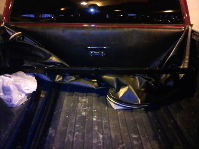

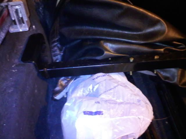

    Here it shows how it simply fits quite snugly in the grove. It does not want to move at all once it is all in there. We did not feel the need for it to be collapsible as it will only go in my truck and because of its snug fit. You can also see how we made the bracket lower to the cross piece. This lowers the COG further making the design more stable.
    Here shows the mount in the middle which will be moved to the bolts on either side along with the one that I received today. A third one will be ordered whenever I feel the need for one.
    More pictures with a bike or two will come later.
    -Brett
  • 01-25-2010
    FastZR1
    Looks good. Nothing better than a piece of equipment that you can make and save a bundle of cash. Lets see some pictures with the bikes mounted.

  • 01-27-2010
    Restoman
    for a primary use I would keep one close to the side. Rear view remains unobstructed and easier to load and unload. Nice craftsmanship.
  • 01-27-2010
    Carraig042
    That is exactly what I am going to do. To my surprise though, there is not much obstruction in the mirror. Thanks guys. Pictures with bike to come when the weather is good.

  • 01-27-2010
    Billy B
    Thats nice! Looka as though there is enough room between it and the cab to slide your front wheels into also.
