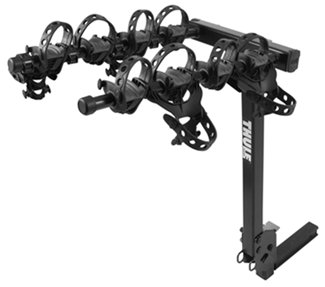

    The problem is: Compact car = 1.25" hitch carrier.
    If you are looking for a 4-bike hitch rack, you will be limited to the hanging types like this:
    There's a good reason for this. Most 1.25" hitches can only handle up to a 200 pound tongue weight.
    The more versatile platform racks that have trays, loops or channels holding the tires, will weigh more.
    My Swagman XC-4 rack weighs 60 pounds all by itself (for the 2" hitch on my Expedition). Add 4 bikes that average 33 pounds each, and that easily adds up to 192 pounds on the hitch receiver.
    If you rig a 2" to 1.25" adapter and put 4 bikes on a platform carrier to mount on your small passenger car, there won't be enough ground clearance. I've tried this on a Forester (which has more ground clearance than a Civic) and that's a no go.
    If you absolutely need 4 bikes to be carried, you may need to go to a custom rack or 2 on the roof, and 2 on a hitch rack.
