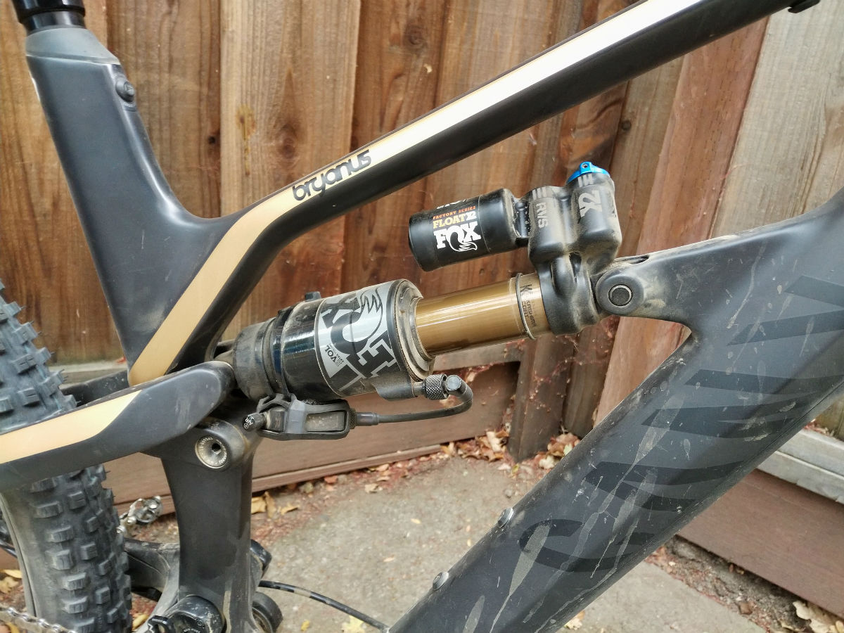

    230x65mm shock fits!
    If anyone is interested, I got a 2019 Fox X2 230x65mm and it fits just fine with no clearance issues on my Medium frame. There's about 1/2" of rear wheel clearance at full compression, and the shock with reservoir up (only way it will mount), leaves about 3/8" clearance at full compression.
    My best guess as far as travel with the 65mm stroke is ~152mm. I used the "bike upside down" method. Measuring with the stock 60mm shock, I got an exact 140mm. With the 65mm stroke, I got 152mm. It was very difficult to compress the shock fully and measure at the same time, so it might actually be a little more. I may give it another shot later and will update with a ride report when I can.

    Quote Originally Posted by bryanus View Post
    I actually just converted my stock Deluxe to 65mm stroke last night. Just had to lower the IFP according to the service manual specs and carefully cut a 5mm spacer off the piston shaft. Im on size XL and also have a half inch of space between the wheel and seat post.

    Quote Originally Posted by CopeSe7en View Post
    Awesome! RockShox makes it so easy. No way to do that with the Fox DPS mine came with. Anyone interested in a DPS? ;-)
    https://www.ridefox.com/fox17/help.php?m=bike&id=861
    Spacer: Metric Travel [.360 ID X .550 OD X 5.0mm TLG] 6061, Black Ano)
    THe part sheet looks like all the same parts for the 60 and 65mm stroke shocks, It also lists a 2.5 and 5mm travel spacer. If you look in the air can there should be a spacer/stroke reducer on the piston shaft. https://www.ridefox.com/fox17/help.php?m=bike&id=861
    It looks like its metal and probably cant be cut off so you would have to basically do a full 200 hour rebuild to get to it. Then just lower the IFP to the 230x65 specs when resembling.
    Very cool info! But honestly, probably not something most of us could handle without special tools and experience. Have you tried to measure the travel increase now that you are at 65mm stroke now?
    From a previous post of mine, I found a couple insights into the travel change:
    Apparently, it will increase the rear travel to 151mm. This was taken from a comment from an analysis of the Spectral's suspension kinematics
    It remains in 151mm approximately and with a cover of 2.3-2.4 I think that there will be no problem, but if you cover covers of 2.6-2.8 I think they are too close to the saddle tube. These issues should always be checked in reality to be sure there is enough margin ...
    But on another analysis site, it was mentioned the travel would be increased to 156mm:
    It could admit a maximum of 230x65 mm damper that would give up to 156 mm, but the problem is the space between the wheel and the seat tube or even between the chainstays and the frame. The only way to know is to check it on the bike directly.
    In my opinion, no more travel is needed in this model. Greetings.
    I just tried to measure it. I got 155ish on my best attempts a few times. Itís hard to measure and keep the bike compressed and level. Made marks on a wall with the tip of the axel. That 156mm number sounds most accurate.
    Thanks for giving it a shot. Let's go with 156mm then. Hmm, I see a fox 36/160 in my future...to balance things out now. Interestingly, the YT Jeffsy CF Pro 27.5 has a Fox 34@160mm, but when I contacted Fox about increasing travel they said it could not be done for this MY and that 160mm is not offered due to performance issues/flex.
    Hey bryanus, any update on the how the bike rides with that extra travel? A pic of the bike would be sick too!

    Quote Originally Posted by nateffb View Post
    I've only had a handful of rides since mounting the X2 65mm, but on some relatively gnarly terrain with long/steep rock gardens, lots of berms, and smallish jumps/drops. So far I don't have anything negative to say about the increased travel. The ride characteristics are still great; there's just more travel on tap now. I was already striking pedals before the swap, but am not experiencing any more now than before, even though I assume the BB is a tad lower at 30% sag on the longer stroke shock. The X2 has a much more linear feel than the DPS it replaced, even with the 2 volume spacers I'm running inside the can. The X2 is an amazing shock; I'm surprised Canyon didn't at least spec the DPX2 or a Super Deluxe RT3; I think the piggyback reservoir would have helped a lot with sustained hits.
    I also swapped out the Fox 34 for the Fox 36 with GRIP2 damper. It came off a Bronson, which interestingly fits up to 2.8" tires in a standard 27.5 fork. It seems the fork has a 'custom internal spacer' installed that allows for up to 2.8" tire clearance. I've inquired with Fox to get more information on the spacer, but haven't heard back yet. My assumption is that it somehow increases the A-C to allow the bigger tires to clear the crown at full compression, and my A-C measurement seems to confirm that it is ~10mm taller than the stated A-C for this fork. I haven't had time to look inside yet, but my first ride on the fork was great. I lowered the stem by about 10mm to reduce the stack a bit. According to my level app, the head angle is right at 65˚. I think if I remove that internal spacer, it might kick it back up to 65.5˚ or so.
    Update: Fox got back to me and said that the fork has a larger bottom out bumper, which reduces the fork's travel by 3-5mm, to keep 2.8" tires from hitting the downtube. So I guess it doesn't affect the A-C like I thought.
    With the increased fork length, the wheelbase also got kicked out a little and makes the bike seems more stable at speed. Only caveat was the weight of the 36. It was about 300g heavier than the 34 it replaced. Overall, still a light bike at 28.7lbs (w/ pedals and cushcore in the rear).

    Quote Originally Posted by 0p3x View Post
    https://www.canyon.com/en/mtb/spectral/
    New specs, shimano xtr 12, 150/160 suspension
    Nice find.
    Wow, they really beefed up the LTD and SL models with Fox 36 160mm up front and DPX2 150mm in the rear. The Fox Transfer post is also an upgrade (IMO) over the Reverb.
    I wonder if they are now using a 65mm stroke shock, to get 150mm, or if they made any actual frame geometry/linkage changes to get that travel. Putting a 65mm X2 on mine turned it into a 156mm (best estimate).
    Also interesting to see they went back to 2.4" Maxxis rubber instead of the 2.6, but strange they use DHR for both front/rear instead of a DHF in front.
    I'm also seeing more house components (i.e. cost cutting?): Canyon brand bars, stem, and hubs possibly.
    I'm a Shimano/DT Swiss guy, so the SL looks to be a much better spec/deal than the LTD IMO. The XTR 12s is sick. And the wheelset uses DT 240s hubs.

    Quote Originally Posted by michaelscott03 View Post
    How do you convert the stock deluxe shock to 65mm stroke do you need any specialty tools?
    No, a 65mm shock fits perfectly with no add'l hardware or modifications (Medium frame, with Fox x2).
