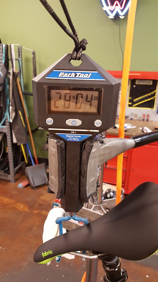

    Huge oppoertunity to lose some weight here. They're about 2100g and you could generally feel the heft. Not terrible but i would love a set of lighter wide-ish wheels.

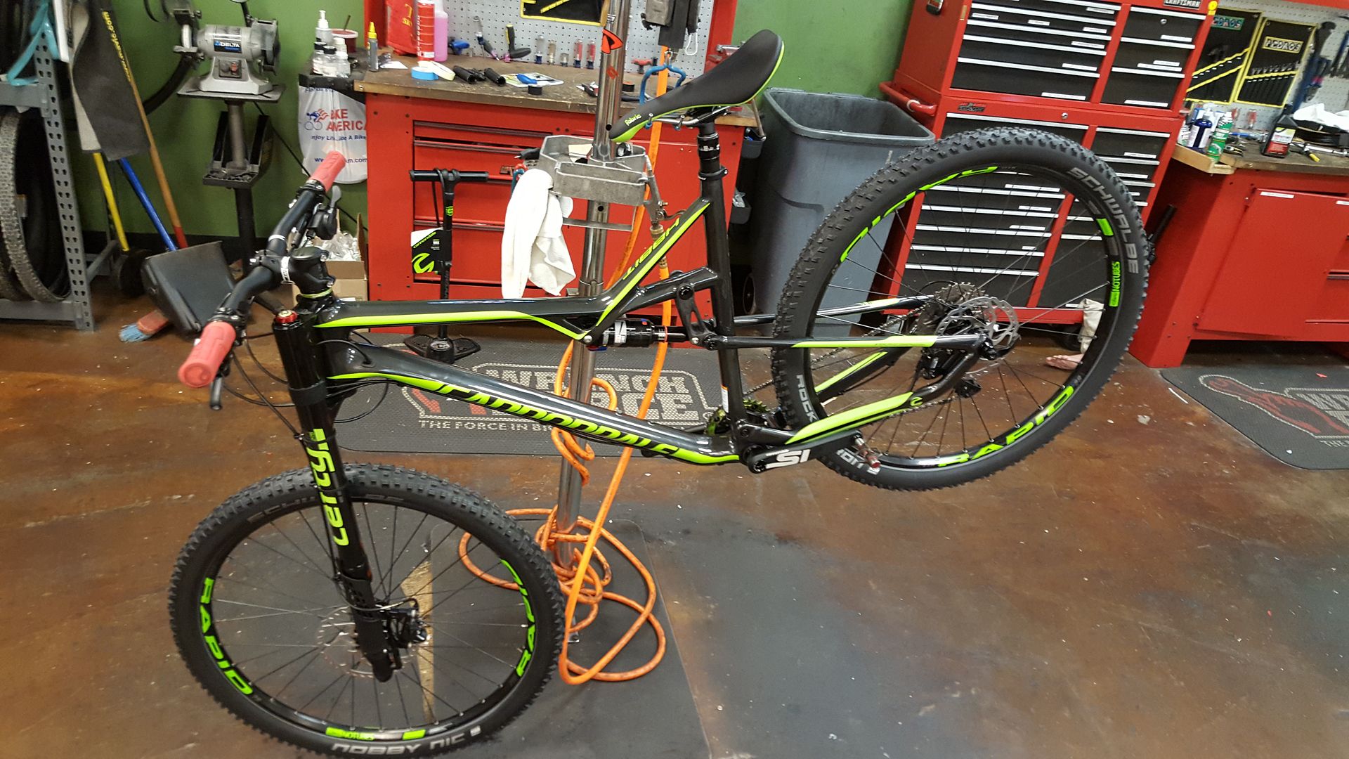

    Here's another quick shot of the build. Setting up the rims tubeless.

    This with ergon GE1, old eggbeater 2s, set up 1x10 with race face narrow wide, and rockshox reverb 150mm (from the blue bike above). Also this is tubeless.
    The wheels are approx 2100g (2700 with rotors which are approx 115g each and cassette around 380g?). So right there there is a huge opportunity to lose weight. Could end up being under 27 lbs with a decent wheelset and carbon bars.

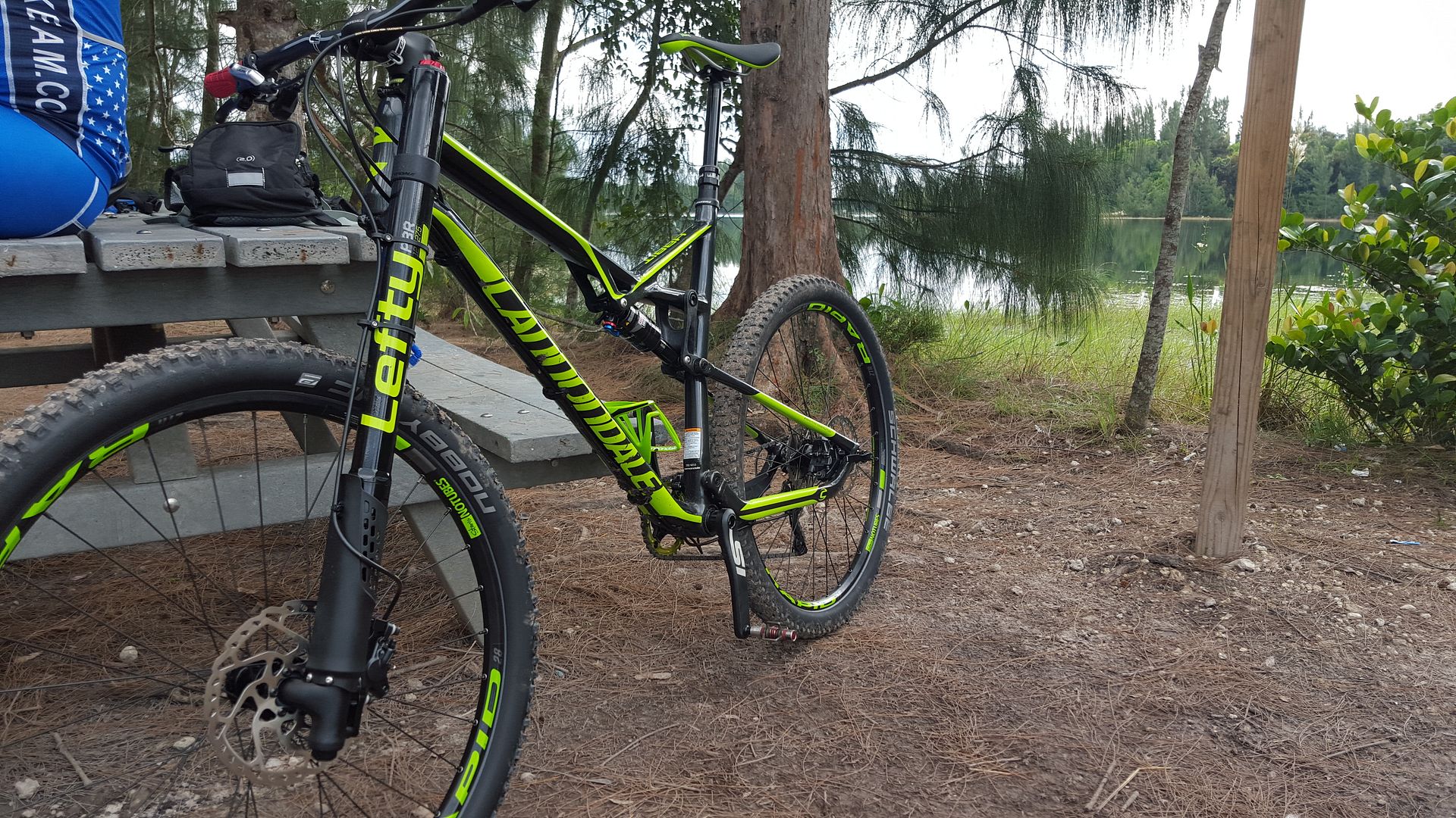

    Just a quickie before work... Gonna break out the DSLR later or this weekend.

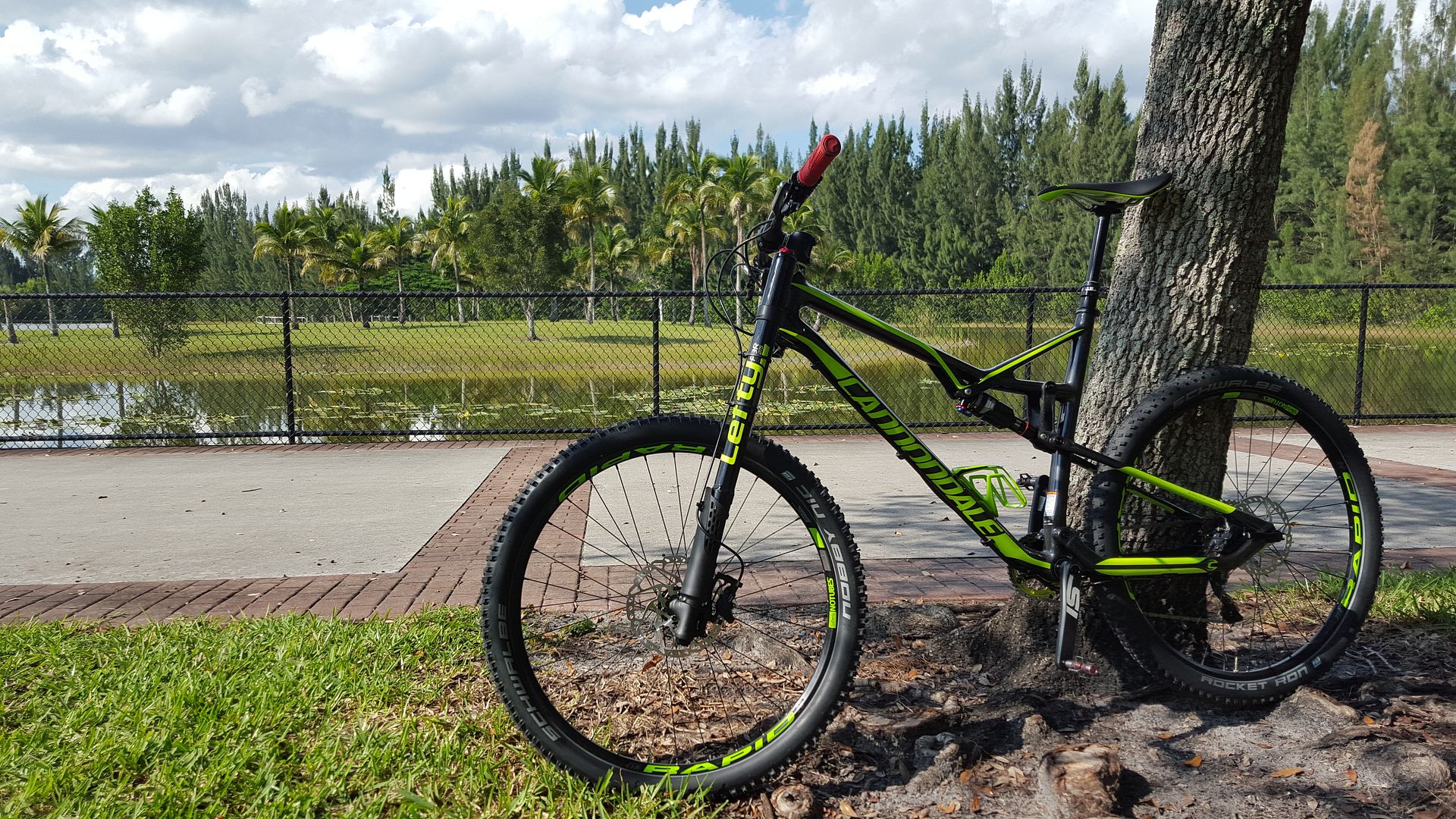

    Can I have a nice scenic shot with it so I can make it my wallpaper at work since mine still hasnt arrived, but it's either shipped or shipping soon. Also, I like the severed foot in the tool cabinet (picture with the bike on the scale).

    this is what i got today. DSLR pics will come this weekend!
    i'm updating the first post now with ride impressions
    haha didn't even notice the foot. yeah the bunch that work at my LBS are a great group of guys. always clowning around and never too serious. can't wait for you to get yours!

    Thanks! I weighed the wheels with rotors and cassette. They came out to around 2700 grams. I subtracted ~110 for each rotor (I know, not exact) and ~380 for the cassette. this is ballpark but I figure it's a decent estimate.
    I've since taken the dropper off the bike and will weight the total weight again (which will essentially be the stock weight minus tubes and set up 1x10), and then again with the tires I just ordered because I LOATHE the tires it came with.
    F: Ardent 2.4 Exo
    R: Ikon 2.35 Exo
    The tires should theoretically add .5 lbs if you accept the claimed weights, but from what I understand schwalbe underestimates their weights whereas Maxxis is pretty accurate.
    I'm not a huge weight weenie (as you can probably tell by my tire choice) but I know people like to know this stuff.
