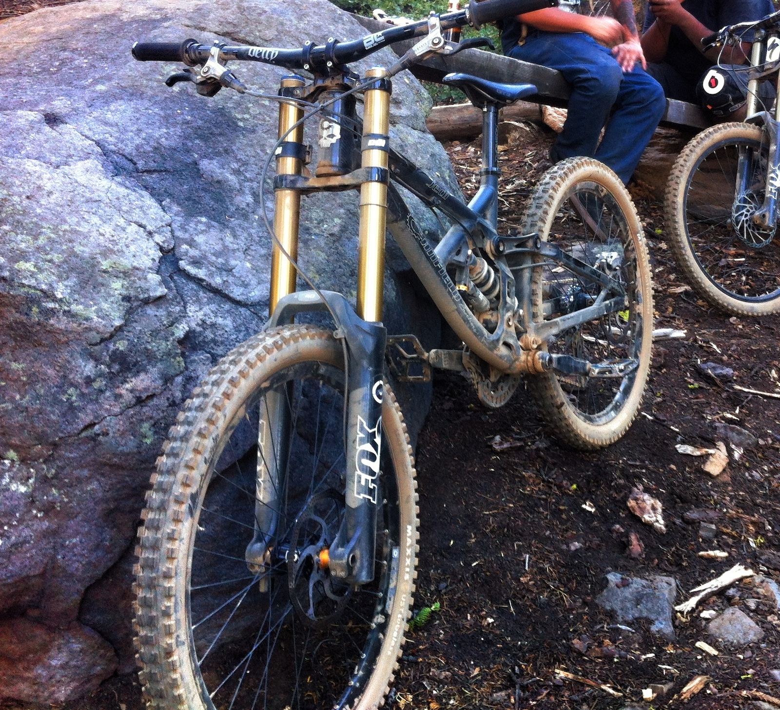

    Finally done!!
    Before:
    After:
    She's just a a hair over 37.4 lbs with Vector Coil and Ti spring. With Vector Air she drops to 36.54 lbs. Funny as she is actually .2lbs LIGHTER with Vector Air than my 2011 One, LOL (no thanks to Hammerschmidt).

    kameraguy
    Thanks guys!!
    The CF wrap is a very cool protection wrap I had left over for a car application. It is thick, but not bulky and so far sticks great to clean tubing. It should be available at a vehicle shop that does 3M protection wrap.
    The X-Fusion shock is fantastic. Still fiddling the Coil settings for the Jedi, but when I used it on my ONE it was awesome. I have also tried the Vector Air because it worked awesome on the ONE, and on the Jedi it is SO nice feeling and WAY easy to dial in. Plus lighter. Honestly I think the Vector Air will stay unless I can really fine tune the Vector Coil to give me that much better performance...but I think i'd be unable to tell a huge difference for my riding ability. The Air is really really nice.
    The reason I went X-Fusion is because I wanted to try something different (Already have a Rocco Air which I really love but it is now staying on the One), and X-Fusion HQ is just 45 minutes or so away from me (used to be 20 before they moved!), they have been great with helping me out so I liked having something that could be easily serviced if needed. Plus when i tried their products I was really amazed at how great they were. Really awesome products coming out of their company.

    kameraguy
    meSSican, right on! It's a small. I am 5'7". You know, I was struggling between getting a small or medium...I think it's a toss up as either would be fine for someone around 5'7-5'8. After throwing a leg over the Jedi, it seems a little shorter than the One of same size. If you like a shorter cockpit, small for sure. But medium is also probably fine if you want to be spread out more. Perhaps give the brothers a call and see what they think.
    Dude!, thanks..yeah i was actually amazed myself. I was thinking it would come in around 39 lbs. Some area that probably helped are the Thomson masterpiece seatpost and clamp, Ti WTB Devo, Canfeld Race rims with Maxxis running as UST. I couldn't justify the e*thirteen LG+ crankset so did the AM/FR version. I guess things could get lighter if $$ allowed.

    kameraguy
    I believe you are spot on. Yes, it sticks very well. So far no problems after dusty NorthStar riding! And I know it is working as there are already little knicks in it, but none that have penetrated thru :)
