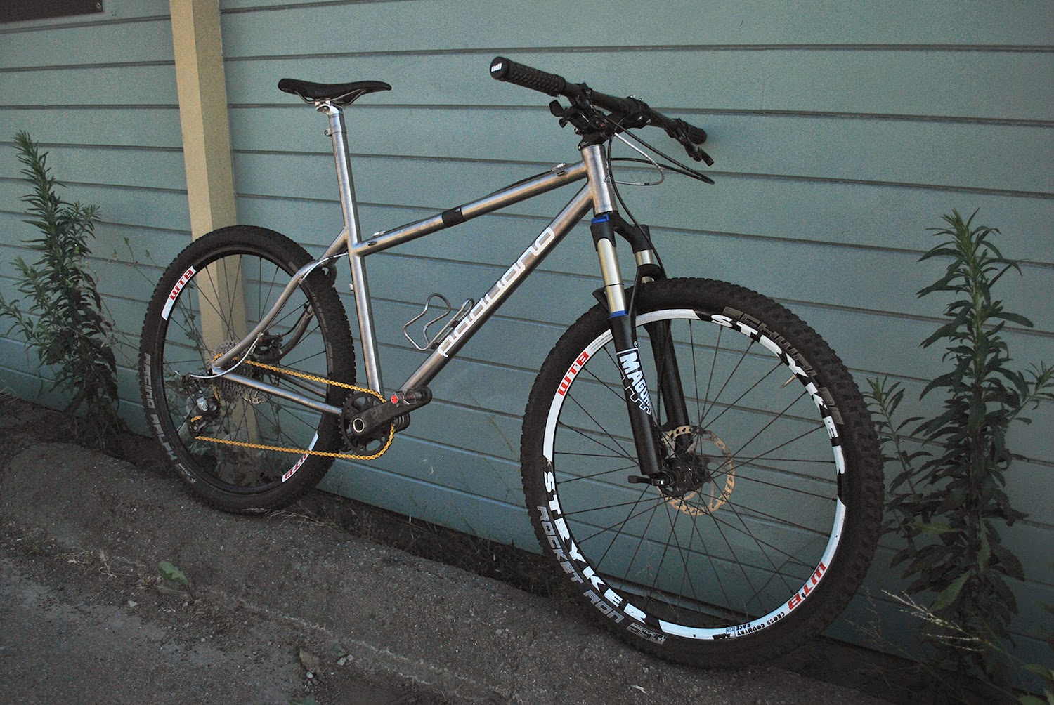

    Quote Originally Posted by nativeson View Post
    canfield, kona honzo? rick hunter's pretty tall and rips his 29er.
    yah - Rick's been building 29ers forever. give him a ring
    Looking for Geometry Ideas on 29'er hardtails - specifically big ones-swamper-hunter.jpg

    Quote Originally Posted by CHUM View Post
Name:	swamper hunter.jpg
    you know who makes a lot of really cool, aggressive 29'ers is Todd from Black Cat. Too bad he doesnt list his geo, though.

    Speaking of Black Cat, I haven't ridden a hardtail in close to 20 years but this is a bike that really caught my eye.
    I love the mini-bullmoose stems that he makes.
    That's a sweet bike. I would've named that stem the Moose Knuckle instead of Mini Moose. But that's just me.
