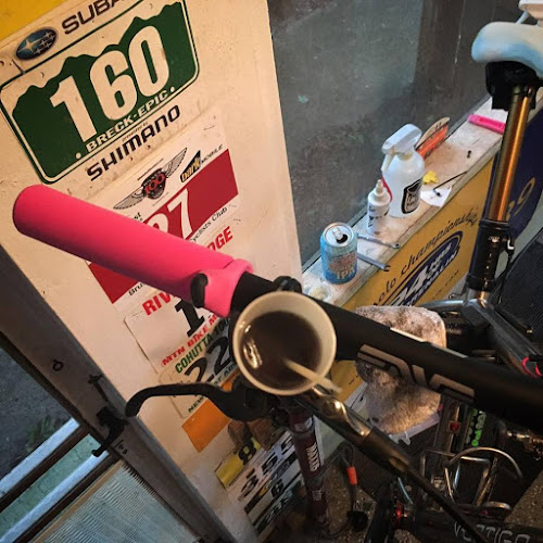

    Personally, I'm going to get into the habit of doing it more often. It's been maybe 5-6 months since I last bled my XTR Trail brakes and this is what I got:
    I've also have experienced what I'll just call "issues" at the brake lever that I've convinced myself coulda been avoided with a shorter bleed intervals. Sticky/stuck levers and leaks... perhaps from a breakdown of the seals and contamination of the lever piston.
    Shimano mineral oil isn't that expensive when you buy the big bottle (divided by the number of bleeds you'll get), the caliper pistons will be happier, it's easy to do, I always notice an improved feel after a needed bleed, and it gives me something to do while I drink beer.

    380
    Mmm, looks like a chocolate shake. I flushed my m8000ís after a month of thrashing them and it was much darker than new fluid, but not frothy looking like that! Amazing they still function really.

    Quote Originally Posted by teamdicky View Post
    That's nasty. Is it from the lever or has it been pushed up from the caliper? If it's caliper I'd drain it out the bottom rather than pushing it up through.
