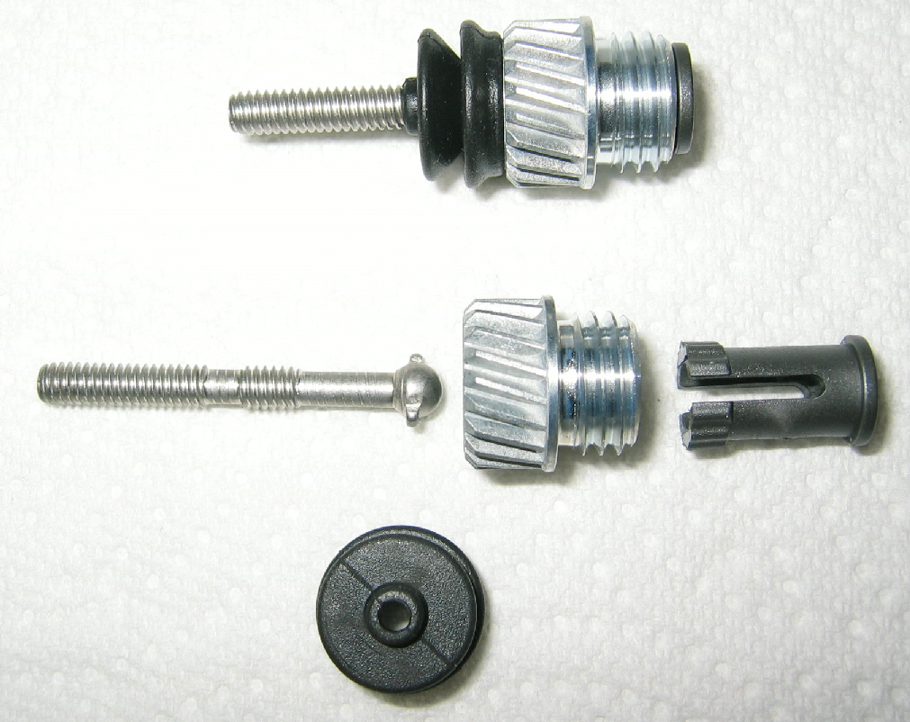

    The caliper is a cheaper casting. It uses an in-line fitting rather than a banjo. The lever is not split clamp. The lever looses the "pop-out" feature. The ability for the lever to hyper extend helps prevent or isolate damage in a crash.

    Uh... I've never used it during bleeding... The pushrod is seperate from the MC... so rather than trashing both... you're at most out a lever and a pushrod, but not an MC.
    Yes, the hose fitting to the caliper.
    Not as nice, probably heavier, probably more flex (thus less power).

    The pros are that you isolate damage... I thought I made that fairly clear. And since you don't seem to get that it's not one piece...
    Pushrod and cup assembly. Pushrod is inserted into the cup. When it's hyperextend, the push rod pulls out. The pushrod is not permanently attached to the MC.
    This is a Hayes MC... The pushrod is part of the entire cartridge.
