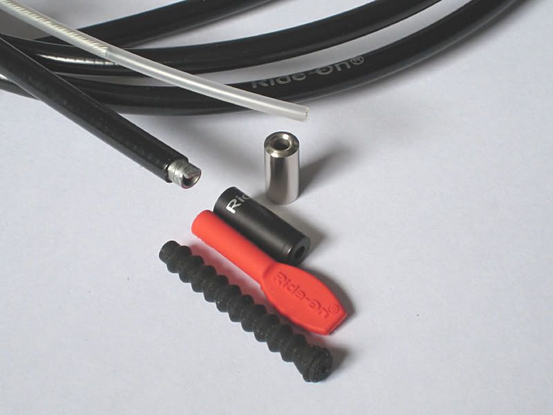

    Does the RideOn sealed brake housing use compression-less housing or is it the coiled type like conventional housing?
    Thanks.
    353
    No, not compressionless housing, but spirally wound like a conventional brake cable (without an internal liner).
    It works on exactly the same principles as their sealed gear cables - in that you pass the separate liner through the entire length of the brake cable run on your frame.
    It works great and is very long lasting.
    1,172
    Thanks! Yeah i wasn't quite sure, was hoping that it is wounded. Nice photo by the way!
