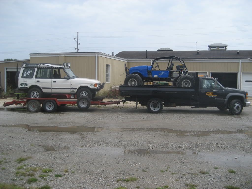

    I had the same problem in my truck; pulling a trailer on I70 through Summit County.
    Stopped at a grocery store in Frisco. Came out and brake pedal went to the floor.
    Bled them in the parking lot and all was good.

    Tell me about it. I was somewhat loaded:
    Losing the brakes on the highway would have brought lots of ugly.
