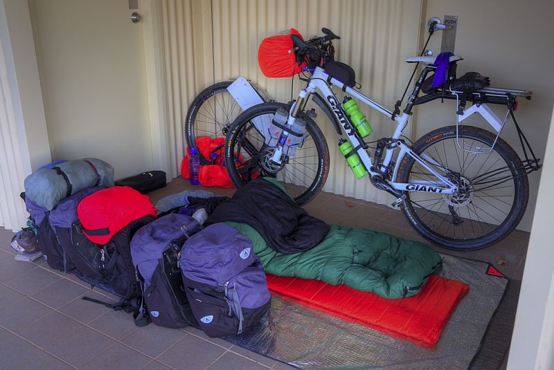

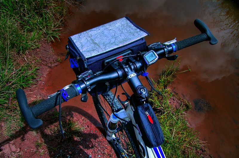

    OldschoolRelo, G'day.
    I've Vaude Roadmaster panniers. They're similar to those that you posted (mine are Black and Anthracite) but mine do not take the zip-on top compartment. I like to ride for up to 8 weeks at a time, without a need to resupply.
    I looked at both Arkel (good quality but too expensive in Oz) and the Ortleib roll top panniers (too many failures off-road with the Ortleibs that I've read about while researching them), so I chose the Vaudes because of the price and the seperate pockets that I could return specific items to and their apparent fine quality. The three outer pockets are a convenient time saver. The panniers come with rain/dust jackets. When a jacket gets damaged, from stacking the bike, or caught on rocks, I repair any tears or holes with yacht spinnacker tape, that I purchased from a boat chandler or marine marine supplier. I do use high-tech waterproof inners for each of the panniers ... 50 cent garbage bin liners.
    Maintenance day. Repairing holes on a rain/dust jacket using spinnaker tape.
    Vaude Road Master Bar Box with removable map window.
    I've had the Vaudes for about 5 years. I try to keep them clean and dust free because I carry several bits of camera gear. They've seen much work. I've taken several long trips mostly on Australia's Bicentennial National Trail and they have not failed in any aspect. Not in the fabric or the webbing, none of the rivets on the back plate have pulled or loosened, the back plate with hangers and fittings have not faultered or distorted nor the zips (there are 3 zips to three individual pockets, a choke string and pair of pull-downs closes the main compartment) nor one loose stitch on a seam. I've 4 Roadmaster panniers and a Vaude Road Master Bar Box. The panniers came with different hanger inserts to cater for different diameter tubing of pannier racks.
    I haul an Extrawheel Voyager Solo trailer (only 2.5kg), for the two heaviest panniers (about 25kg), which keeps the majority of the weight off the bike.
    Formally dressed, with the rain/dust coats on .... I've a hi-vis pannier pig.
    You mentioned heal strike, the hangers can be slid forward or back on the pannier back plate and then tightened, to give good clearance.
    Warren.
