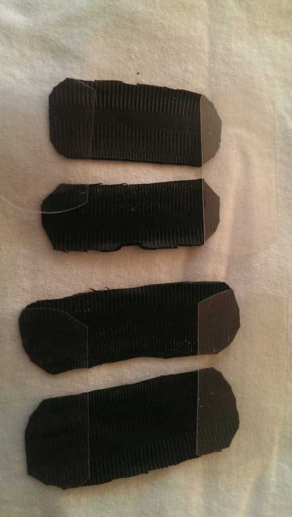

    IME - Only if it's a small tear.
    When a sidewall rip gets big a tire boot will keep the tube from sticking out and scratching every rock on the trail.
    These are made out from old tire sidewalls, and the plastic packaging at home depot.

    I was on a road ride last year. About 15mi from home my tire sidewall blew. I had a spare tube but no spare tire. Right after I called my wife and asked her to come get, some dude on a semi beater bike rolls up and asks if I needed any help. I told him what happened, and he opened up his bags. FILLED with spare tubes and components for various types of bikes.
    The guy guy me a hard sliver of an old tire to put under my old one. Worked like a charm. Some people are prepared, others are not, and some have moving bike shops on wheels.

    Quote Originally Posted by Jorgemonkey View Post
    See, guys like that live to save the day for unprepared riders like you. If not for your slovenly ways his life would have no meaning.
