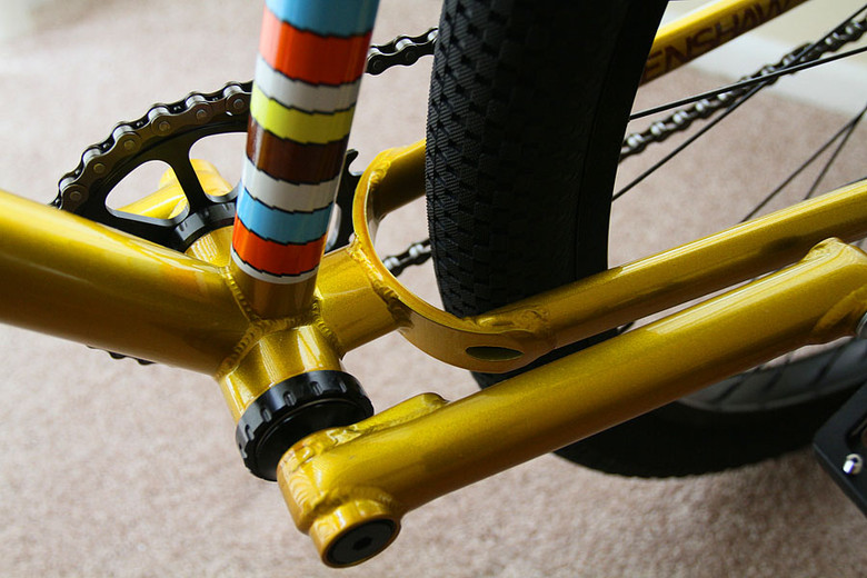

    If your BB is external then it looks something like this:
    Where your frame (yellow) is surrounded on both sides by large cups (black) with notches evenly spaced around the edges for removal. That will require the BBT-9C for removal.
    As for the BB, you'll need something like this:
    Amazon.com: Pedro's Bottom Bracket Socket - ISIS Compatible: Sports & Outdoors
    ISIS compatible means that it should worth with most internally splined BBs that you will come across.
