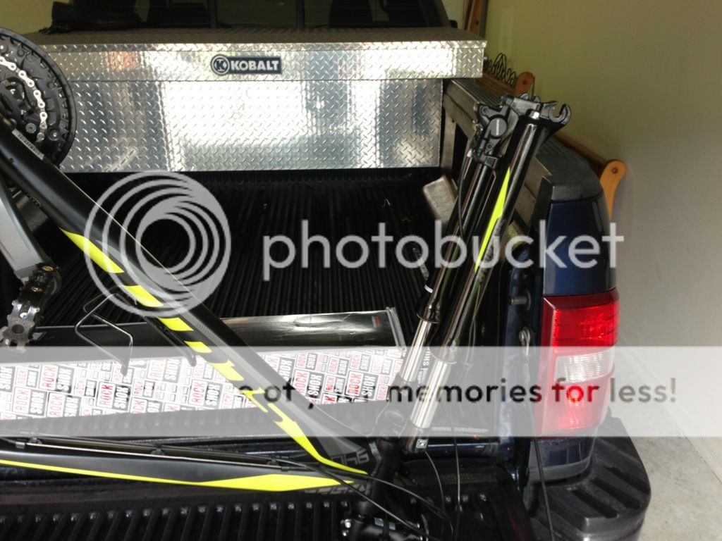

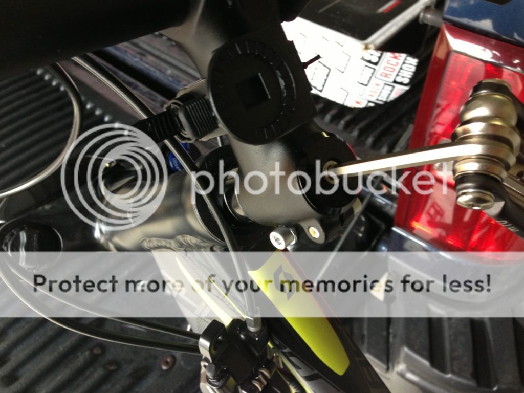

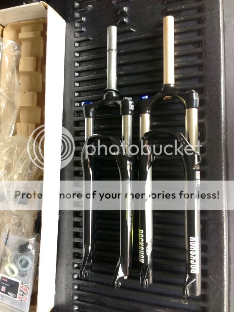

    Heres some pics
    Heres the Aspect 940, all stock.
    Wheel removed

    Star nut bolt? Not sure what its called. It preloads the headtube bearings
    Stem off, showing spacers
    Comparison

    All done!

    It looks like your new fork already had an appropriate crown race installed. If it had not, that's a key step worth mentioning.
    I actually pulled it from the stock suntour fork, and it worked like a champ.

    Quote Originally Posted by A DuB View Post
    I just swapped the same crappy Suntour for a Surly 1x1, and could not figure out why I still had play in the fork. Must have taken it apart a dozen times. Finally got frustrated, took it to LBS, and realized I had kept the crown race that came on the Surly instead of swapping over the one on the Suntour. Dumb mistake, totally overlooked on my part.
    Definitely a good point to remember.
