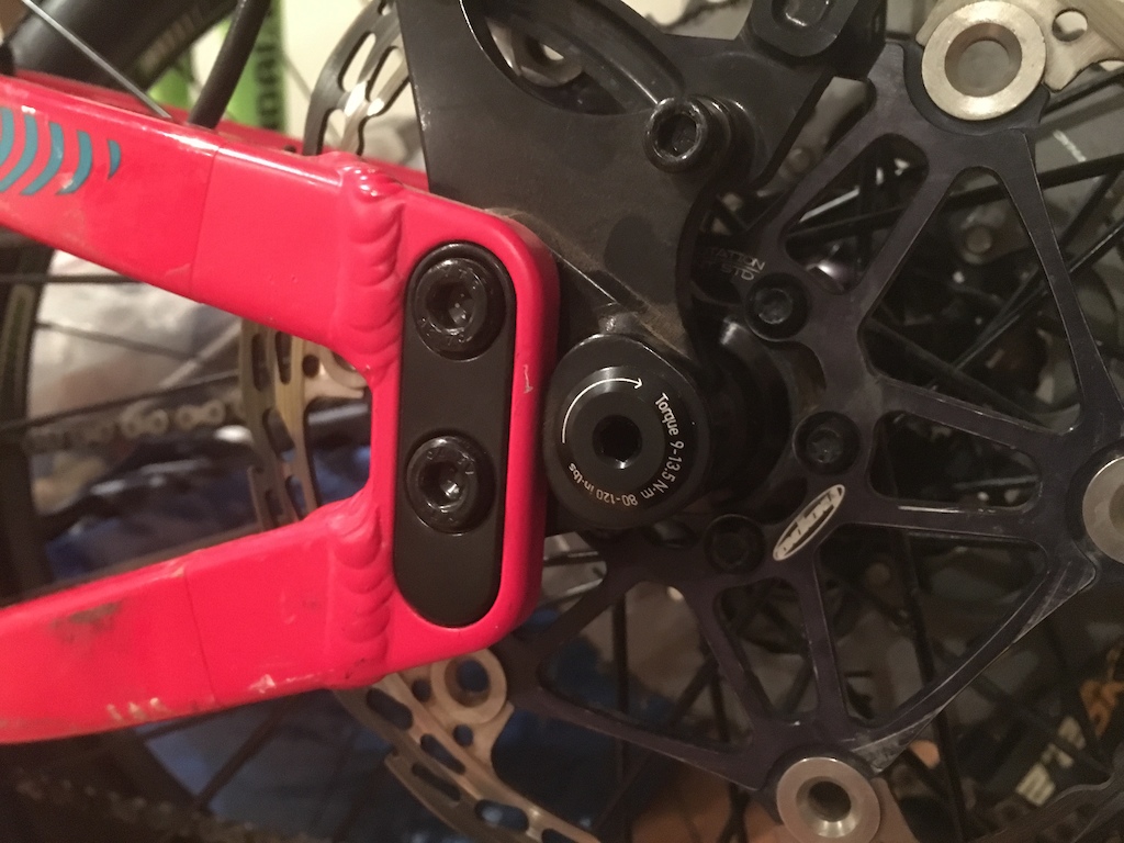

    Just in case anyone wonders:
    I've had great success with on my 2017 Boosted Phantom with this axle
    Maxle Stealth Rear Thru Axle: 12x148, 180mm Length, Boost
    really great fit, it's really flat and sits below the surface of the stays.
    Original DT swiss RWS lever got snapped pretty fast and it was PITA to get it removed without the lever.

    I bought this one as well, SRAM parts number 00.4318.005.028, works an absolute treat. Thanks for the tip @geoya ! (45 grams vs the 61 grams for the original DT axle and lever but who's counting? )
