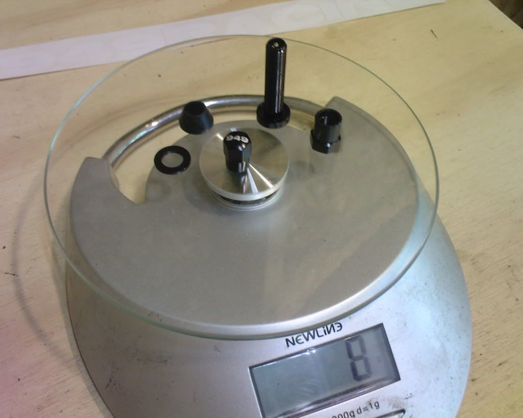

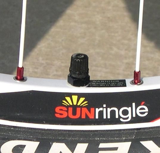

    $4.25 ea, shipped
    confirmed 8g w/alu cap
    large rubber washer
    schrader dominance

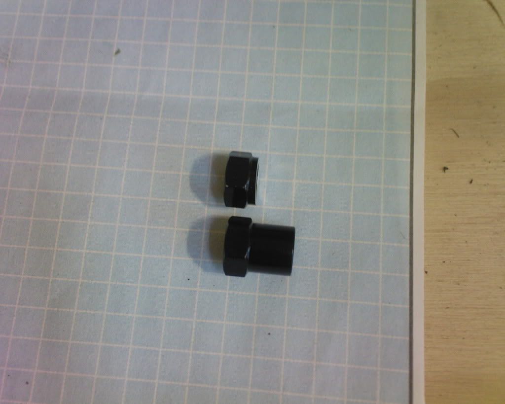

    These are gorilla tape's best friend. I had to cut several mm off of the retaining nut, but otherwise a perfect setup for those of us who hate presta valves.

    Quote Originally Posted by Moe's Tavern
    $4.25 ea, shipped
    large rubber washer
    schrader dominance
    Was the retaining nut too tall to allow the cap to snug down?
    Its hard to tell what the nut looks like - here or on the website; is the nut tall in design?
    Or is the threaded valve just on the short side when installed thru the rim?
    Correct, the retaining nut was too long and interfered with the cap. I think the retaining nut is extra long to protect the threaded body of the valve since it's original design intent is for car racing. The valve is not "short", rather it's designed for automotive applications, not double wall mtb wheels. Hacksaw off like 6mm and file smooth. Takes one minute. Another advantage of these valves is the rubber washer is thick and conical so it can accommodate a non-flat interface in the drop center portion of the rim.

    Thanks much for the info & especially the photos of the components; just as I had assumed, the double-wall rim thickness affected the fit of the nut.
    The mfgr. should put images & measurements on their website for that item!
    The product looks nice; I'm going to order some for my rims.
    BTW
    Anyone ordering these, if you have a Dremel tool, you can use a disc cutter to more easily cut/shorten the nut (& make a nicer cut than a hacksaw), and it might not even require filing afterward. Available where Dremel tools are sold.

    Tubeless with 949 schrader valves
    Quote Originally Posted by thomllama View Post
    hey, anyone using the 949's notice the seat sticks up above the rim bead?
    ...thinking I might pull them and replace the seat/seal with an O-ring to lower them below the bead lip...
    I just did the 949's on a SUNRingle Charger wheelset.
    Charger Pro | SUNRinglé
    These rims have a pretty deep section between the inner & outer walls, so in order to have a workable valve-stem length I had to cut the shoulder off the lock-down nut and trim the conical rubber seal.
    The seal is surprisingly soft and easy to cut with a small pair of scissors. Everything buttoned-up slick as can be.
    The o-ring idea would probably work too. Or maybe a neoprene washer.
    The seat of the valve stills protrudes a bit into the tire "bed", but has caused no issues.
    I also slipped a thin mylar washer between the lock-down nut and rim to keep from marring the paint.
    These valves are tough to beat for anyone going tubeless. They are sturdy, the installation is simple, robust, & fuss-free, they're freakin' light, and CHEAP!

    I just finished installing the 949 valves in my Flow EX 29 rims. I'm so happy to be rid of the stupid prestas and adapters. I've yet to hear a single sound reason for why they are better than schraeders.
    I turned down the caps and nuts on a lathe to shorten them. You could do the same with a vise and a hack saw, or a dremel tool, or just by picking up normal nuts/caps at the hardware store.
    We'll see if i have any trouble holding air. The only reason i would is if i didn't do a clean enough job on the rim tape around the valve stem.

    does my picture show up?
    Bend, OR
  80. #80
    Reputation: GR1822's Avatar
    2,106
    Picture shows, welcome to the world of schrader tubeless.

    Speed Evolution Schrader stems with different lock nuts
    Tiny Presta-type locknut from a Stan's or pbikestore Schrader stem; 3mm thick...
    This locknut leaves about 12mm of exposed threads.
    An aluminum hex locknut from an automotive stem; 4mm thick...
    This is in a 20mm-deep rim, so theoretically you could run this valve stem in a 25mm-deep hoop and still have 5-7mm of exposed stem to get a pump nozzle on.
