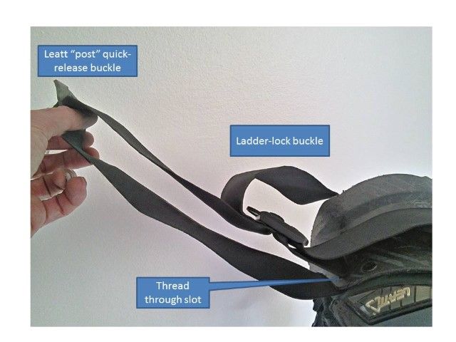

So I wear Dual-Axis on every single MTB ride. The guard itself is very tough but at several hundred ride hours per year the elastic straps wear out.
Unfortunately the straps are sewn into the protector and are not replaceable. Except, they are. Very easily it turns out.
The key is to get quality elastic, with at least 125% stretch and braided construction. This is serious, expensive elastic but it is the only thing that will work. Don’t bother with the 30% stretch cotton stuff available locally and on Amazon.

I paired 2 inch elastic with 1.5 inch ladder-lock buckles.

The oversized elastic does not go through the undersized buckles with complete smoothness, but it works fine. And the 1.5 ladder-locks are a lot cheaper than 2 inch. But I now believe 1.5 inch elastic would be strong enough too.
If you use the Leatts on bare skin, the perforated neoprene part of the straps may be important to you. This or similar material can be sourced and sewn in without difficulty using a Speedy Stitcher or finding someone with a machine. I always wear Lycra for MTB and enduro pants for moto, so plain elastic is fine and I cut away the neoprene when it wears out.
Now, simply make a loop using elastic and a ladder-lock. No velcro, no sewing, completely adjustable. Once you get the length adjusted you can use the quick-release buckles and pretty much ignore the ladder-lock.
