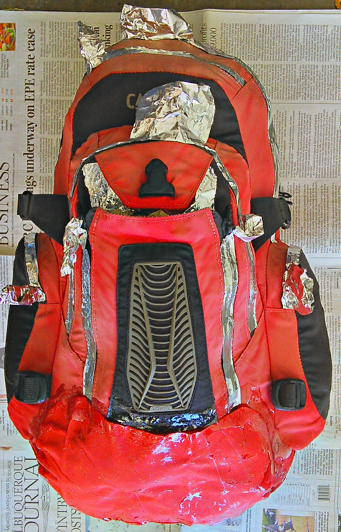

    The first step was to fix the rip, so I loosely stitched it back together:
    Then I cut out a piece of Cordura pack cloth and put it on with the contact cement technique.
    In other words, I coated the patch and the patching area with Aqua Seal, let each dry for about 30 minutes, then pressed them together.
    For coating the rest of the pack, I decided to try thinning Seam Grip to make it more brushable and hopefully reduce running.
    This might seem counterintuitive but I had a feeling that a thinner coating would stick tighter to fabric because of surface tension. I could not find toluene locally (chlorinated neurotoxic carcinogenic solvents are out of fashion) so I got a quart from Amazon.
    I cut open an 8 oz tube of Seam Grip and squeezed it into a glass pickle jar. I then diluted it with 4 oz of toluene. This seemed like just the right consistency. (To prevent curing in the tube or jar, store in the freezer.)
    Stuffing the pack with newspaper and packing bubbles was the most work. It needed to be completely full and bulging because the coating would lock everything into position.
    I masked all the zippers with Nashua aluminum duct tape folded into thirds and then cut with scissors. "HVAC aluminum foil tape" is great for masking because it is easy to work with, impermeable to liquids, and easy to remove.
    Cordura patch in place (bottom) and everything masked with aluminum tape:
    The diluted Seam Grip painted on nicely with a 1-inch brush. As I had hoped, there was almost no running at all.
    As soon as the Seam Grip was set firmly, I removed all the masking to check for runs.
    Once the Seam Grip was completely cured, I sprayed all the zippers with B'laster silicone spray. This made them much easier to slide.
    This project took several hours work but I now have a pack that will last for a very long time:
