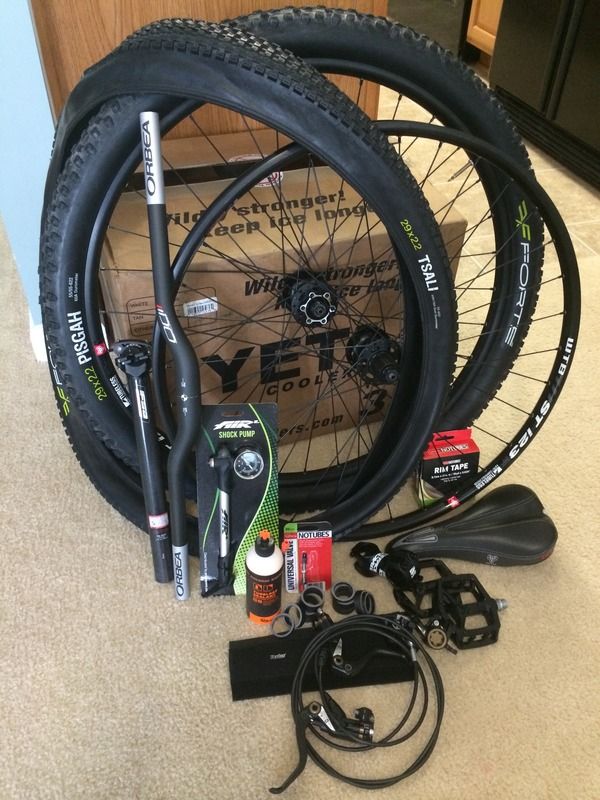

    So I ordered a Seeker the second they came in stock Monday 7/27, but still haven't got a tracking number. It supposedly shipped Friday and I'm concerned about missing the FedEx guy. We'll see... I'm trying to be patient considering the excellent deal!
    My plan is to make this 29er lighter than my previous Cannondale 26" (27.8lb). I will weigh the whole bike, before and after, and all components I swap to hopefully help guide others. Also, I'm trying to do this for only $100 or so after selling the OE parts.

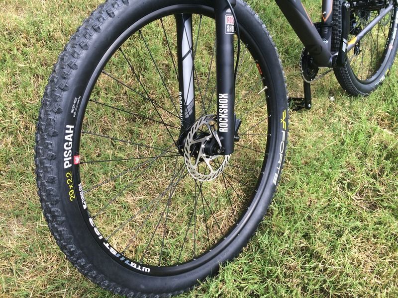

    So far I have the below lonely parts waiting in a big pile:
    FSA carbon 0 setback post
    Orbea carbon riser bars
    FSA carbon stem spacers
    Race face 60mm stem
    WTB ST i23 on XT hubs wheelset
    Wellgo MG-3 platforms
    WTB speedV saddle (not light but it's what I like)
    Magura MTS brake set (may keep the new DB1 brakes since they replaced the mediocre Elixirs)
    Forte Pisgah/Tsali F/R tires
    I'll be going tubeless with Orange Seal, stans tape, stans valve
    Neoprene/kevlar chainstay protector
    Stay tuned for updates!

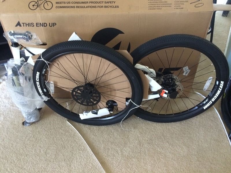

    Update 8/8: It's Arrived!!!
    Bike got here just before noon and I ripped into the box immediately. As I opened the box I noticed the new Vee XCV tires and DB1 brakes that were mentioned on fb. It was all packed well, no damage aside from a cable housing that was crushed but still functional.

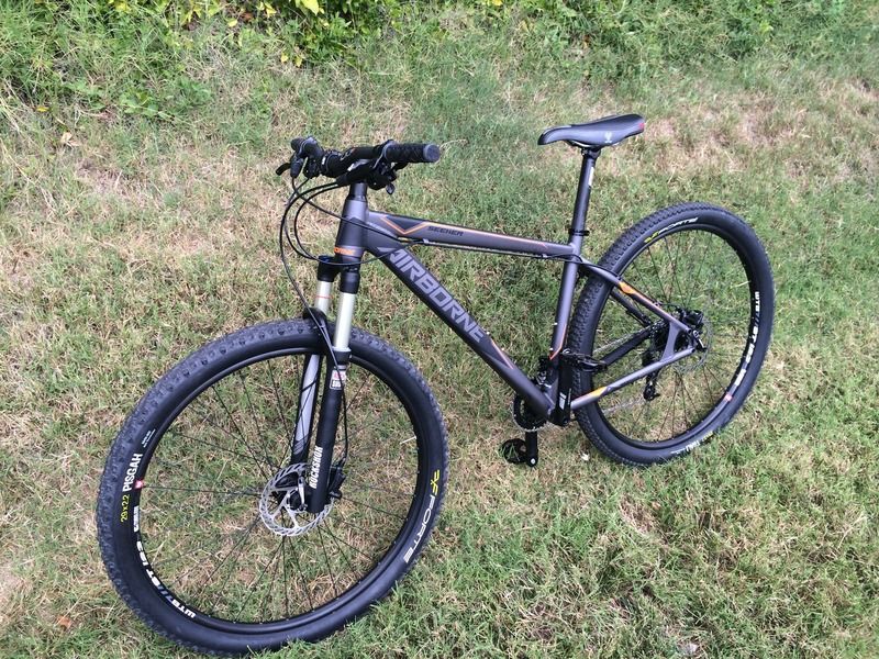

    I assembled the bike as is for the sake of weighing it. My medium Seeker weighed 29.8lbs as it comes w/o pedals, about 1lb heavier than I've found posted elsewhere. After weighing, I began swapping all of my upgrades while weighing each piece for reference's sake.
    I had a used 19mm wide 1850g wheelset that I won on ebay, but came across a great deal on a new WTB ST i23 on XT hubs wheelset advertised as 1940g so I decided to suck up the 100g weight penalty. Unfortunately, when I got the wheels and weighed them, they were a whopping 2371g. I really like them so I decided to keep them, gave them some stans tape, and installed my Forte Pisgah/Tsali tires with tubes temporarily to help ensure to tape sticks (a trick I read about here). I'll pull the tubes and go tubeless sometime during the week.
    Adjusting the derailleurs took me a little bit of time while watching youtube videos to walk me through it. The brakes also needed to be aligned. Hulk must have installed the rear caliper but the caliper mount wasn't even tight. Everything else seemed solid and gave me no second thought about taking it to an LBS. If you have common sense, know your limits, have basic tools, and general DIY know-how, you can assemble a bike with little trouble.

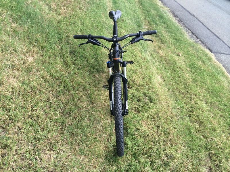

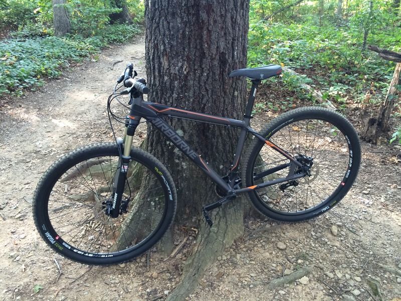

    After getting everything together, I rode it up and down the street before taking it up to my local easy 3.2mi trail.
    I did not hit my 25lb goal because the bike was 1lb heavier than I thought and my wheels ended up being a 1lb heavier than I initially planned. So my Seeker weighs 27.05lb(once I pull the tubes), which is still 1lb lighter than my old 2009 Cannondale F4Z 26".
    I'm very happy with my purchase, despite the shipping/communication issues we're all experiencing. I even got a couple compliments on the bike after my ride. I'm glad I went with the 18" because I hate the look of the bent top tube on the 16", the ETT length is near perfect especially with a 60mm stem (could probably go 80mm), and while standover is a bit tall I can still stand flatfooted if i move "the boys" over to the side.

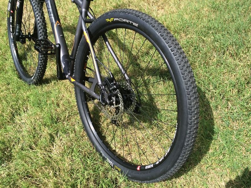

    I went 1x10! The 36T was too tall for me since I'm not a very strong climber and the 22T is way too small. I don't like having to constantly shift between my front rings and I found myself doing it constantly out on the trail. I went with a RaceFace narrow-wide 32T and am sticking with the OE X5 rear derailleur. I contemplated a 30T but on my ride today I only had to use the 36T twice, and on the high end I got up to the 13T on a flat fireroad-like section which is rare around here. So far I really like the 1x10; No dropped chains, no chain guide or clutched derailleur. I'm going to stick with the 32T unless I find myself need more low end, but hopefully I'll build my leg strength up more before I get to that point.
    Removing the front shifter, derailleur, 36T, 22T, and 22T ring's bolts I dropped 390g, or 0.86lb! Component weights have been added to the lists below.
    I also finally swapped out the DB1 brakes for the Magura MTS set I had laying around. I didn't have any issues with the DB1's, but just like the MTS's better due to lever shape and decreased likelihood of rubbing issues. I'm now sitting at 25.82lb.
    Edit 9/13/15: After 3 weeks of riding a few different trails in the area, I find myself in the larger end of the cassette more often than not and have never hit the 11T or even spun quickly on the 13T. I have found myself on a handful of occasions, either when gassed or on days that I just don't have a ton of energy, where I wanted another gear on climbs. Therefore, I just bought a 30T RF NW, in orange for some bling . I'll keep the 32T just in case, but I think I see why most factory 1x drivetrains I've seen have a 30T for 29er's.
    Installing the 30T was pretty simple. I kept searching around to see if I'd need new bolts for the 30T on an X5 crank, but couldn't find anything definitive, so I just waited until it arrived and went for it. Thankfully, the OE 22T bolts worked perfectly! So 32T or larger, use the OE big ring bolts, 30T use the OE small ring bolts. Only took it for a spin around the neighborhood with my fiance', but I suspect this will be the perfect gearing range for me. Should I ever find myself wanting more top end, it's only a 15min job to swap out to the 32T. Still no dropped chains using the X5 rear Der and no chain guide.
    Also, I think I forgot to mention here that I got a custom wheelset built. I was disappointed that my ST i23/XT set was a full pound heavier than advertised, so I found some excellent deals on components and sold the heavier set locally. I went with Frequency Race i23 rims, BHS hubs, and Sapim Race DB spokes. This set came out to 2050g incl Stan's tape and stems, and best part is it only ran be a touch under $350!

    Jerz - Lets see a pic of all the goodies you have waiting to install tomorrow!!!!

    Update in OP.
    197
    Bike was delivered a little while ago, almost done assembly and installing the new parts. The 18" size is tight on standover height as I expected being 5'8 with 29" inseam but I just move the "boys" to the side and I can stand flat footed without shoes.
    I'm taking some pics and weights of everything along the way.

    Looks good looks good! I got mine, all assembled, seems good so far - I have to go get an adapter for this type of valve stem before I can ride mine - So I am off to the bike store now.
    Overall this was pretty simple to assemble - If I were to take it to a LBS - it would only be to get the front wheel 100% parallel with the stem/bars
    Fedex was not as gentle with my box. There was a lot of rubbing on one side of the box like they shoved it against something that was constantly impacting that side, the cardboard protectors shifted enough that the seat post dug several chunks into the paint on the frame, and some dulling/rubbing of paint where the tire rubbed the frame.

    Sadly i'll be sending this bike back. FedEx can reimburse me, or Airborne or both of us..
    There were 3 different spots that the paint was damaged due to rough shipping...
    The rough shipping also caused the front brake spacer to fall out - this in the long run ( over-bled or over-adjusted the front brakes ) caused the front brakes to have an engagement which is about 30% less than the rear brakes - I am one of those anal people who like the front and rear to be identical in feel, grip, engagement, etc.
    The front tire is out of round - Im not sure if it's bent, if there is a flat spot, or what happened - but i'll sum this up to a shipping problem too - any time im going over 8mph the entire bike has a rhythmic pulsation to it from the front wheel. If I free-spin the front wheel in the air, it's very visible that the tire has a significant flat or out of round spot in it.
    I could have dealt with one of these issues - but not all 3.
