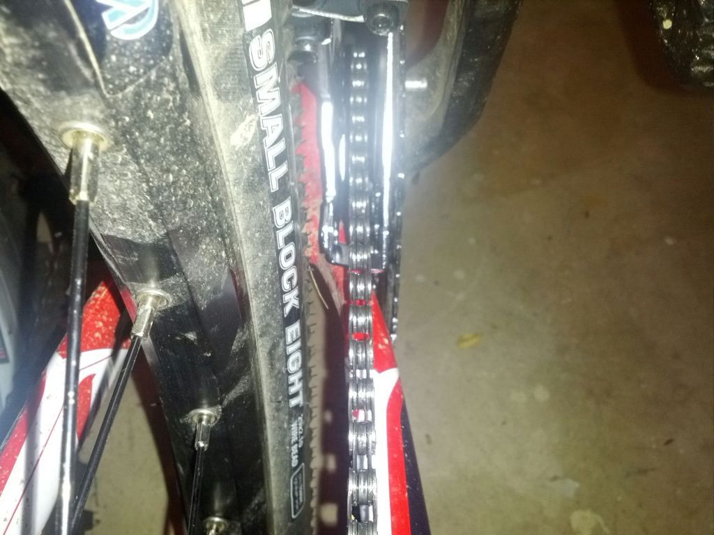

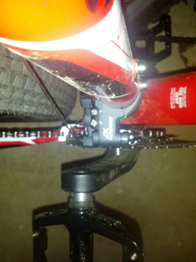

    Problems with clearance issues with the front derailleur with the tire?
    Seems clearance is a big factor with this frame running certain tires...
    also on the front derailleur there is a screw on the tail of metal piece that rubs my tire per rotation because a small bulge on the kenda tire...
    I had called Airborne and they said nobody has had issues reported yet...so I'm curious if this is true or not...
    Would running a x7 or x9 front derailleur help with taller/wider tires?

    Post some pics of the clearance issue.
    28
    The LBS got it where the derailleur screw there was not rubbing the tire anymore...but its pretty darn close still. Also between the derailleur and tire I cant stick my finger in between them...so a taller tire would gunk up mud, dirt, and etc... there pretty good (if i could even run a taller tire *tire with taller tread*).
    26
    Wow, too close.

    Regarding the FD, it is somewhat close when shifted down into the small front chainring, but it doesn't hit. This is a bit of a compromise on a 29er with a 3x9 system. The clearance is the best we could make it. That's part of the reason why 2x10 systems are advantageous on 29ers.
    The X7 FD and X9 FD have a rivet instead of a screw that holds the cage together, so they will offer 2-3mm more clearance for a larger tire.

    28
    Quote Originally Posted by BigDaddyFlyer View Post
    Awsome! Thanks!

    Promised a picture of the stock FD to the stock rear tire clearance earlier...
    As you can see, not a big deal unless you go for a fatter rear tire.
    Welds on this rig are gorgeous. Bottom tube is monstrous, ovalled rectangle that is taller than it is wide at the head, yet transitions to be wider than it is tall down at the bottom bracket. Yields stiffness where you need it at the top,
    and strength laterally where you want it at the bottom.
